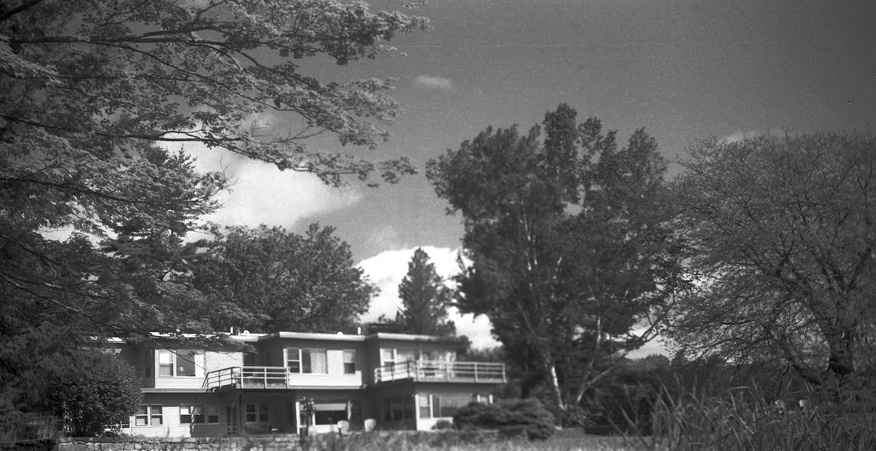

Good morning fellow folks,
I recently purchased some Tmax RS developer, I had been using Xtol, which I like I just don't like the huge batch you need to make and I don't develop huge amounts of film so it usually doesn't last. D-76 seems to be good, easy, cheap, stable. But since I use a lot of Tmax film I figured The Tmax dev would be good even though I'd heard mixed reviews. The first roll I did came out with all these spots, tiny, everywhere. I thought maybe I used it too soon after mixing part A and Part B.
So, i ran out of D-76 and thought to give the Tmax a try again. TMax 400, 1:9 dilution, 11:25 @ 75F (per Kodak #4043). No spots but grainy and muddy as all get out. There are so many dilutions, which is good? 1:4, 1:7, 1:9? It did say the larger dilutions would yield grainer negs.
And does it always have to be 75F? I like 68F.
Please excuse the out of focus center, a little film flatness issue and the cat hairs on the cat!
What is the magic formula for TMax RS? :D

The TMax RS dev and I have come to an agreement. 1:4 dilution @ 68 and I filter my fixer now. It's been fine and has given good results. :D Thanks for all the input!

To be fair, I don’t think the developer requires me to filter the fixer, but since I was having unexplained spotting it was suggested that maybe my fixer had schmutz it it. So I just do it to be sure. It did have schmutz in it.
