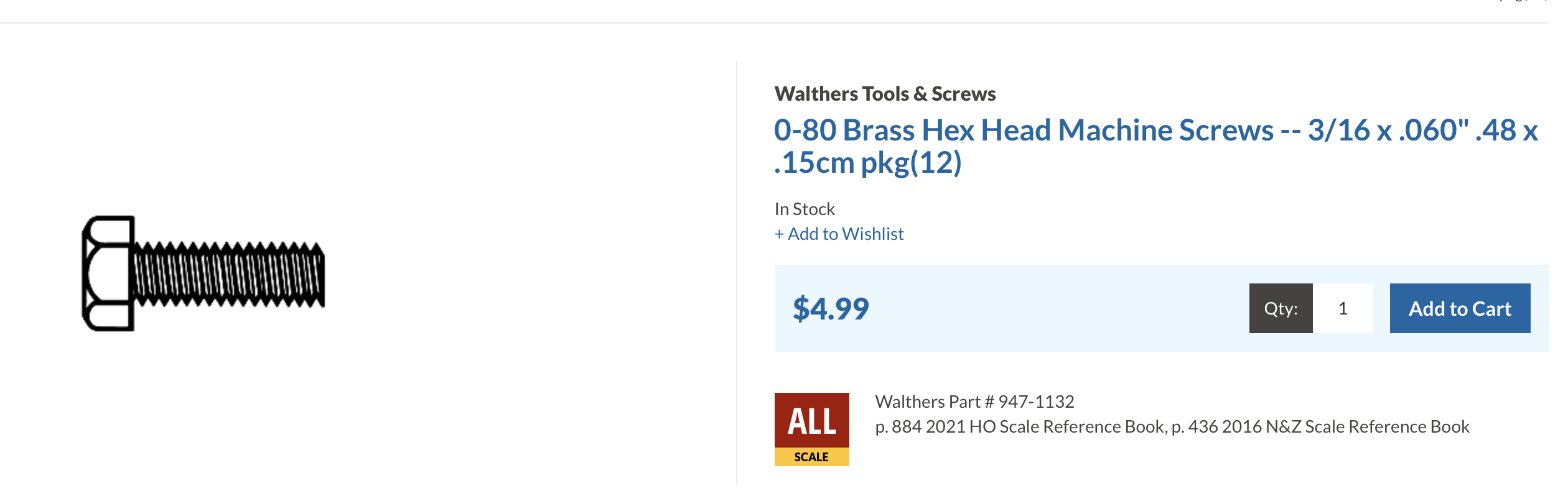

You could try Fastenal, they are pretty good for low quantities. Pan head screws also go by button head.
It might be hard to find an 0-80 with 1/32 thread length as that is very short. You may have to file a longer one down.

Walthers has some that are very close.

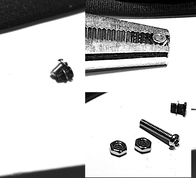

I was just shortening an M3 screw last week. I put two nuts on it, cut it and file the end. Then unscrew it from the nuts and that preserves the threads on the end.
