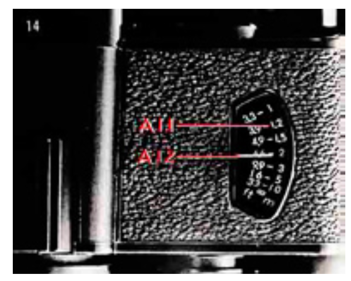

Another way to do it, that I did once, is to have two scales. One scale is permanent and, when the rangefinder patches agree, it shows the distance to subject on the scale (presumably for 127mm lens). Now you have just used the camera as a rangefinder to determine the distance to subject. On the other side of the bed would be interchangeable scales for each lens. Set the lens to the correct spot on your homemade focus scale for that lens. Focus scales would be easy to make.
This would be one step better than 'zone focusing' but not as nice as totally coupled.
Hope that helps.
This is how my camera reads out the distance with the rangefinder, and this number is transferred to the lens by moving it to the correct location with the focus scale. These scales will work with any camera btw, so feel free to copy it for the 105 focal length.

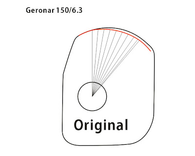

The Polaroid cam is a semicyclone on a pin, so the Graflex is irrelevant. You could figure out by focusing manually and noting the necessary cam measurement to make the rangefinder align at various focus distances.

Lots of great information here from the chap in Korea who made the Byron conversion:
I did contact him a few years ago to see if he would make a cam for me as he has a complete machine shop facilities but he wasn't able to.
I think I know who you talking about, Icanberry? this guy only knew 150mm calibrations. He died of heart attack and was homeless. never delivered the work near end of life and wrote some crazy things on Facebook towards people asking for progress/refunds, got banned from many groups during that time.
ABSOLUTELY valuable info. Thank you 3d printing for a rapid prototype. The rest is up to brain power to problem-solve this haha.
