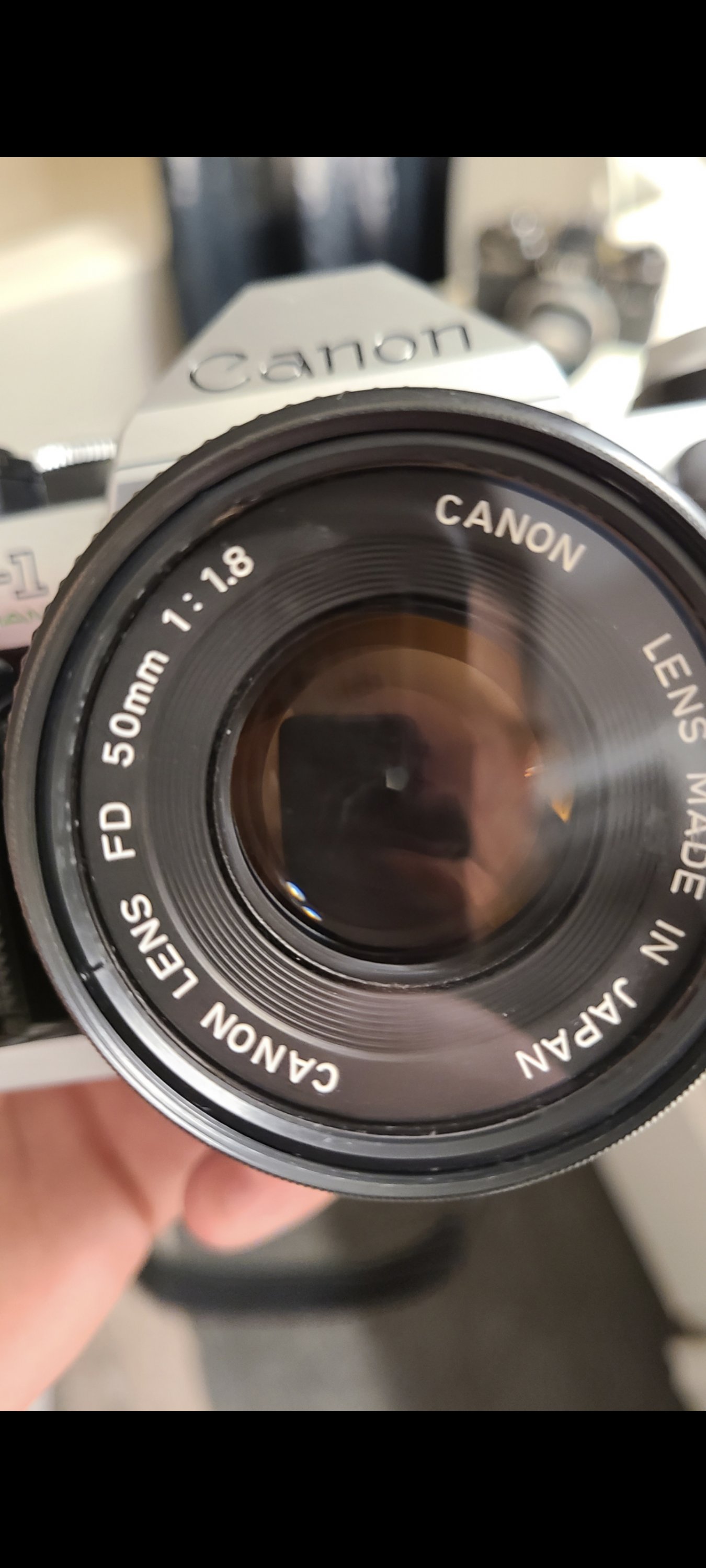

I have a canon ae1 program with a fd 50mm 1.8 lens. When my lens is mounted the aperture is stuck at I'm guessing f2.8 ,I only can change it to 1.8 anything over 2.8 it does not change. But if I take the lens off I can change it manually just fine. What is the problem here? The lens or the camera ?
Set a slow shutter speed
With lens on camera, open the back.
Set different apertures on lens and fire camera while looking through lens from the rear.
Does the lens stop down to different diameters with different aperture settings?
When mounted on the camera the aperture should remain completely open no matter what you set it to. It only stops down to the chosen aperture when you take a picture. Does your lens have a green "A" setting? Set it there and you pick the shutter speed, the camera will select the aperture.

A mechanical link tells the lens aperture to stop down to shooting aperture when the shutter button is pressed.
The FD mount system allowed automatic diaphragm function, and a new signal pin (compared to FL mount lens) supported full-aperture metering.
A second signal pin for the "auto" setting of the aperture dial, plus a linkage to allow the camera to set the degree of diaphragm opening, enabled integral auto-exposure.
Understanding that will help to diagnose where your problem originates, in the inability to change the aperture ring position.
Also, when off the camera, a FD lens aperture shouldn't change when you rotate the aperture ring.

I have film loaded

Waste one frame. Set to slow shutter speed and f/16 and release while you are looking into the lens. If you’re lucky you’ll also get a self-portrait.
I tried it with bulb setting and held shutter while I had it set to f22 and the diaphragm was not closed anywhere close to that.
Okay idk what I did but it fixed it self. Wth
