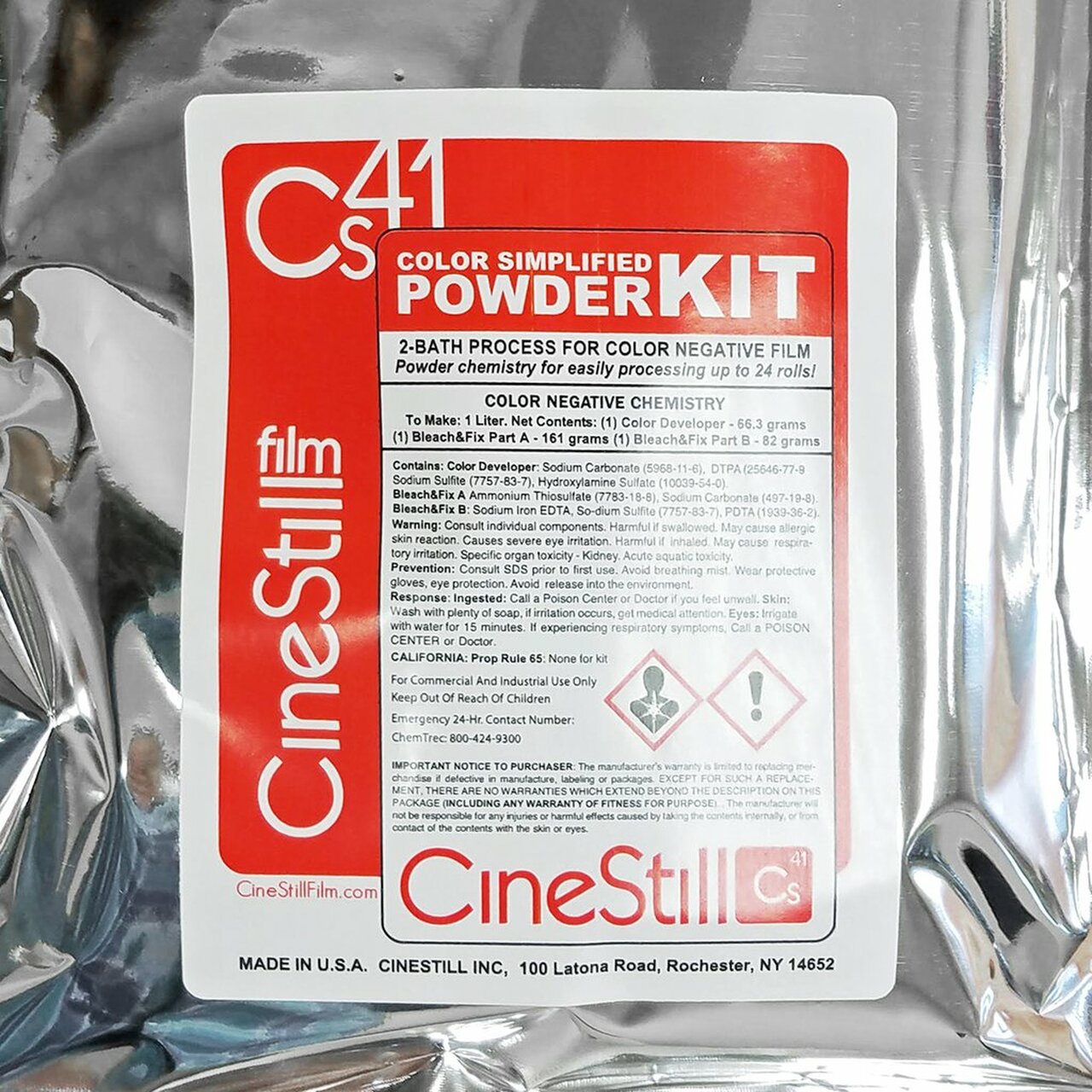

Hello my good colleagues.
- I know perfectly well that chemistry is not the best option, but it has become a tangible reality, whether we like it or not.
- Some of my fellow Egyptian photographers who live in distant governorates (maybe 1000 km) in the far south, they asked me to prepare the chemistry in the form of a powder, and the internal shipping in Egypt is actually very bad and mostly does not accept shipping liquids and if he agrees to ship them The probability that the parcel will arrive intact is a low probability.
I had a discussion with my Austrian teacher, Engineer/Rudi.
And I reached some points, and there are some points that need clarification and search for solutions.
And the most important of those points are.
- How to solve the problem of adding potassium iodoid percentage in dry form.?
- I think that the manufacturers of this powder chemistry rely on the (ECN2) formula, but they do not declare that, and the evidence is that they often advise that the photographer use a temperature of more than 38, I say mostly, but not all of them., And of course the formula ( ECN2 does not contain potassium iodide.
- There is also another evidence to support this subtraction, which is that the life span of this powder chemistry is only two weeks and not six weeks, as is the case with liquid chemistry.
In general, I opened this publication and I hope that you will not spare me by expressing your valuable views on this subject,
thank you in advance
Please accept my highest respect to you.

What you see in the bag is the MSDS declaration. It is not a complete disclosure of ingredients but only the ones with safety or enviromental concerns. It is very probable that iodine is added in such a low quantity that it is not necesary to declare it.
This is my question as well.
If we assume that this recipe contains a small percentage of iodoid, if we assume that it is, for example, 0.002 grams,,
The question is: How can this very small amount be obtained, as there is no scale that can obtain this percentage. Therefore, it must be done through a liquid solution,,
The second question: How is that liquid solution dried?
I am not looking for the formula for that company.
I can use any other recipe.
But I just wanted to consult in order to find out how to add a very small percentage of potassium iodide.
I wanted to find a way to dehydrate a potassium iodide solution in order to add it to the powdered recipe.
May be you can send 1g of Potassium Iodide in a small cover? And ask the user to dissolve it separately in 1l of water and use only 2ml of it?

I don't know much about color developers, would it make a really significant difference to just leave the iodide out?
I tested the various DIY C41 developers that stefan4u posted on this forum (the ones you linked to in your post). I specifically experimented with including the potassium iodide and leaving it out. I did not observe any ill effects from leaving it out, but I did notice that all of stefan4u's formulas gave results that were different in terms of color balance from factory-made Fuji C41 developer. The results were usable, but not optimal. When it comes to DIY-ing C41 chemistry, the risk is very big that the results won't be up to official standards and in that scenario, I guess that it doens't matter much anymore if the iodide is added or not.
@mohmad khatab I think your best option is to mix the dry components of your C41 developer in a relatively large quantity so you can accurately measure the iodide. Ensure proper mixing; you will likely need an industrial mixer for this that guarantees a homogeneous mix. Package the chemistry under a controlled environment particularly ensuring that any air that is sealed into the containers has no humidity, or (better) vacuum seal the chemistry in a suitable polymer bag. You will then have to make sure the developer is sold within a fairly short timeframe to limit the degradation that will likely result from the activator being packaged along with the developing agent. Alternatively, you could split the developer into two parts, one with the developing agent and another package with the other parts.
An alternative route that may be easier has already been suggested to you: include the iodide separately as a solution in a vial. Since this vial only needs to be quite small and can be packaged securely with ease, I don't see any major drawbacks to this approach.

@ mohmad khatab
Do I understand correctly that you would like to send to Egyptian fellow photographers some Cinestill C-41 kit(s) in powder form, but you are worried because you thing the Potassium Iodide is missing in that powder kit.
  1. Do you have evidence that the Cinestill kit does not work properly?
  2. As pointed out by halfaman in post #2 above, the KI being absent from the MSDS does not mean it is absent from the developer.
Hello my dear brother .
Yes, you got everything almost right.
But with regard to the potassium iodide element. I did not say that it is not present in CineSteel powder.
But I wanted to inquire about the method they used to add that ingredient in such a small amount.
It is assumed that any formula needs at least 1 MG at least, and this requires that a dilute solution be made of one gram of potassium iodoid + 99 ml of water, then we take from that last solution 10 ml + 90 ml of water, and then take one ml And we add them to the developer.
Well, after all, we can't get that percentage in powder form.
- And the question was, How can we dry this quantity of potassium iodide solution?
- I didn't accuse Cine Steel's chemistry of not being good.
But at the same time, there are some people who said that the difference between it and the chemistry of Kodak and Fuji is a noticeable difference (in favor of Fuji and Kodak of course).
- There is no evidence that sinesteel formula contains potassium iodide and there is no evidence that it does not contain potassium iodide. But it is just a guess, and I provided some evidence that might support that.
Powder chemistry is an important economic market, and it is unreasonable to leave this sophistication to emerging companies in order to enjoy it alone without competing with them in it, unless they have scientific and perhaps ethical reasons that prevent them from entering this growing market.
- And if you try to think a little about those scientific or ethical reasons that might have been the reason behind the failure of Titanal, Fuji, Kodak to break into this market, we might think about the formula.. This confirms that the ideological obstacle will remain.
- Morally, it is impossible for Titan, Fuji, Kodak to manufacture chemistry using a formula they do not own. And who is the owner of that formula, do you know?
I doubt, I think, and I'm almost sure it's Mr. Zone V's formula - which is the formula I gave in my first post, and it's the only formula that doesn't include potassium iodide. This is a matter that is consistent with logic, and is consistent with the position we are dealing with.
- From a scientific point of view, I do not claim to be an expert at all, but what I am sure of, is that the three major companies have very accurate scientific standards that they work according to and they cannot allow any juxtaposition in any scale and
Certainly and without any doubt at all, there is no way that this powdered chemistry formula would meet the scientific standards of formula (C41), because if it gave the standard results, why did Titanal, Fuji, Kodak leave this fertile market and refrain from offering powder chemistry?
Jul 28, 2016
2,803
India
- From my point of view, this is what is happening, and the proof of this is true, that all the respectable (reputable) photographic chemistry companies did not produce powder chemistry at all, for example (according to my information) Tetanal did not produce powder chemistry
Tetenal did produce powder based C41 Press Kit.
mohmad khatab
mohmad khatab
Sep 8, 2012
1,228
Egypt
It wasn't a fertile market. It was a small niche and all companies you mention have been struggling with the dramatic decrease in demand for film products 20 years ago, which led to r&d being ceased and products eliminated.
And what about now that the water has returned to its normal course? And the demand for photographic chemistry is steadily increasing?
Titnal Company has produced some new products, such as the box that contains enough chemistry to develop one roll.
koraks
Nov 29, 2018
23,672
Europe
It's still a marginal market that simply cannot bear the weight of additional r&d. If you believe that the market is anywhere near where it was 20 years ago, you're very much mistaken. It's maybe 1% of that.
