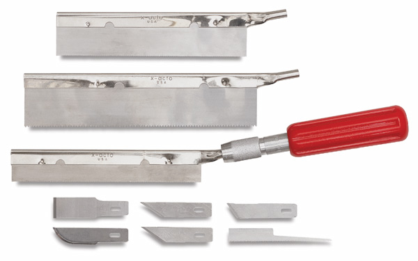

The 50mm Hood I have looks like this. If I were doing this I would use a small 'coping saw' to cut your 80mm to shape. I would use a fine toothed saw like this:

X-acto sells a small miter box that would be helpful for guiding saws such as the one that ic-racer illustrates. If you use such a saw with a very fine blade and a light touch, you probably will not crack the plastic. After doing the cut sand all four sides at once by mounting some sandpaper on a piece of glass or other smooth, flat surface to clean up the saw cuts and get it all even.
Cutting a profile like his Rollei hood would be fairly difficult though. A true coping saw maybe could do it, but most coping saw blades are pretty coarse, the risk of cracking the plastic would be substantial. A router in a router table with a really fine cutter would be a good way, but it would also be a good way to turn the hood into scrap instantly, and perhaps your fingers too.
What sort of tools do you have available? You could easily spend more in tooling than the cost of the hood.
Of course no project is worthwhile unless it provides an excuse to buy more tools.:wink:
That type of saw is called a "jeweler's saw."
A coping saw is a handsaw with a fine blade stretched in a frame for cutting curlicues, scrolls, jigsaw puzzles, and such--

The first saw is a "razor saw" the second is a coping saw. A jewelers saw is similar to the coping saw but takes a much finer blade & is slightly shorter( about 3" high).
Thats right, not a coping saw :surprised:. The one I actually have was sold for notching a guitar nut, though no one would know what I meant if I said 'nut saw.'
