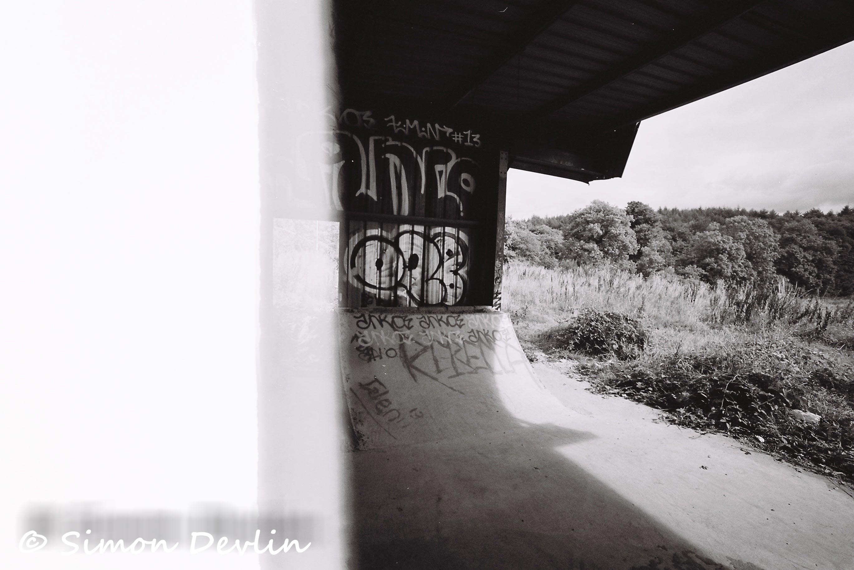

I really like the ME Supers, my other one seems to be working although I had a few problems with the shutter curtain partially remaining open and would like to know how to fix it, you can see this below.
This was the first one I bought, most of the frames were fine (maybe a bit of light leakage on only some of them). Ilford XP2 film developed and scanned in the cheapest of cheapest labs!

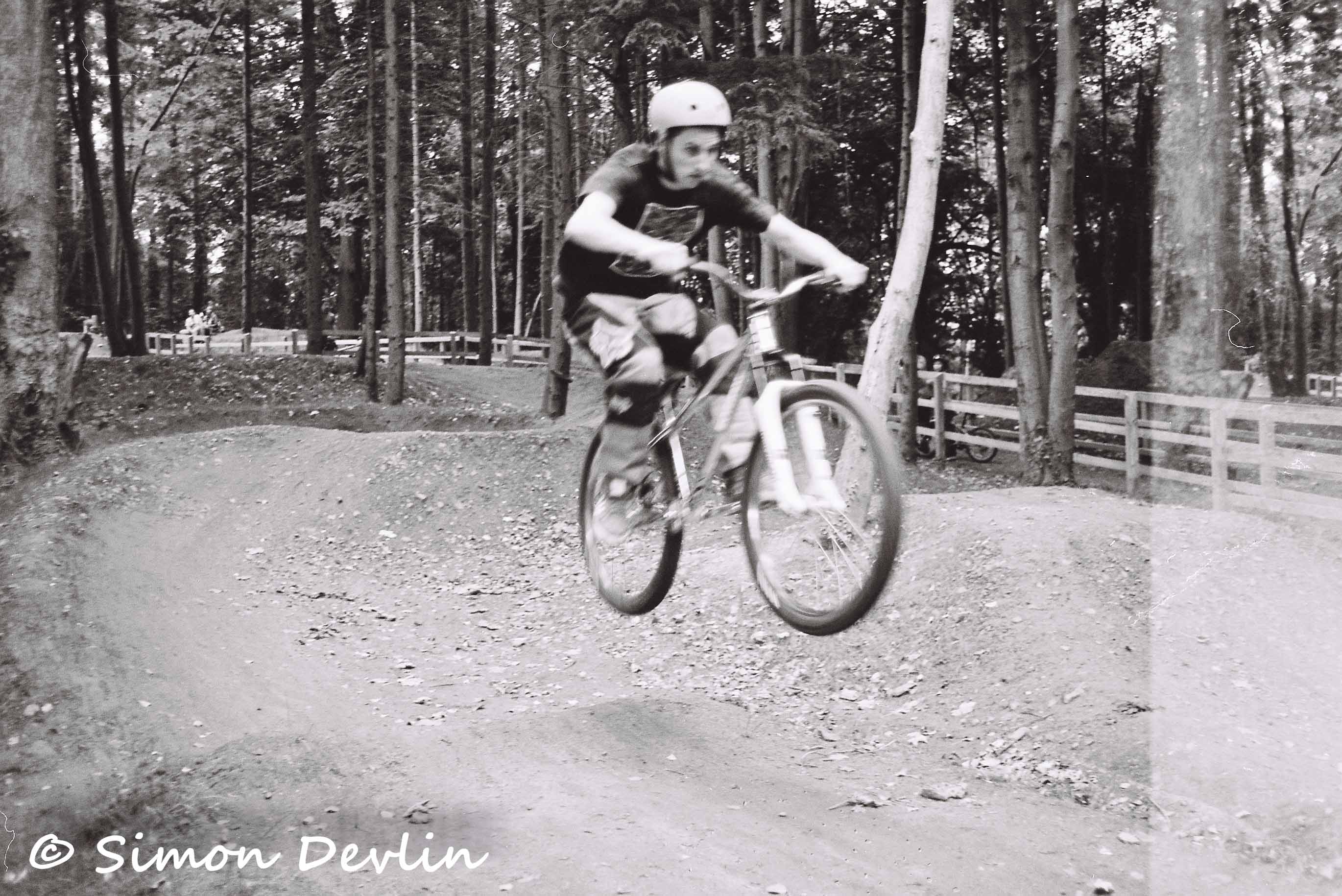

And this one not as bad, apologies for the rider not in focus!
