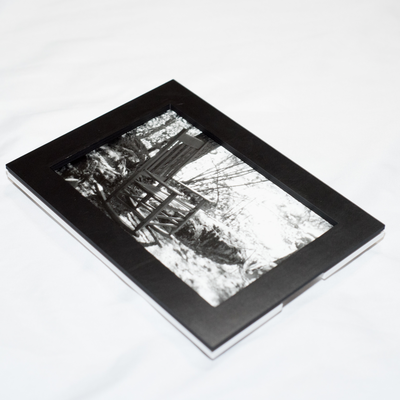

Some of you may already know me from various 3D printed negative carriers and accessories for various enlargers, The latest on those is I am working on ANR glass carriers for the larger enlargers as well as carriers for the C760 and LPL 4550.
But today I wanted to share some work I've been doing for making some simple easels for darkroom printing. These were inspired by the difficulty in finding 4x6 Speed-Ez's which itself came up from a recent postcard swap I participated in (on The Naked Photographer's discord).
Unlike Speed-Ez's, you place the paper directly into an inlay and place the top down rather than sliding it across. The finger notch is used to lift the top and paper up once you are done making an exposure and there's rubber feet to keep it from moving around.
This works well for RC paper, including Ilford's Portfolio, though does not currently work well for fiber paper. I'm looking at what I can do for fiber (including using hidden magnets to help press the paper flat) though for now I would recommend using these with RC only for now. On the pro though I can make customized tops. So for instance, if you need to make a 4x6 print (say for a postcard swap) but don't have any 4x6 paper, I have a 4x6 crop top for the 5x7 easel which includes guidelines to trim the paper while keeping a white border. I can also make a top that can be used to make a 4x6 borderless print, or one for a square crop, etc.
I recognize most folks here are likely doing more serious photography and likely already have a capable easel. But I have found these preferable when I'm working with 4x6 and 5x7 and want just a standard border. In particular, I prefer 1/8" borders on my smaller prints whereas my Speed-Ez's and 2 blade easel use 1/4".
Anyways! If this is something you might be interested in, feel free to send me a PM or check out my stores:
https://www.etsy.com/shop/bitbybitphoto
https://www.ebay.com/str/bitbybitphoto

Great idea. Is plastic sufficiently thick and rigid that so that will remain flat over time?
Even metal Speed Ez-Els can warp, as witnessed by some I have purchased used.
Chris
That's a fantastic question Chris!
What I have found in my own testing that, yes, it stays pretty flat. I started working on this months ago with various iterations (using magnets, among other things) and those designs are still very much flat. The times I've had issues were when I was impatient and didn't let the plastic cool before removing from my printers, oops!
Flatness overtime is something I haven't tested beyond those few months, but I don't think it will be a problem save for one exception - if your darkroom gets very warm, storing the easel upright in your darkroom might cause warping over time. I say might because it's something I will be testing in my own darkroom (which gets hot in the summers when I'm not actively cooling it). I've been doing those tests with my carriers (which I advise not to store in very hot spaces either) for several months and, though I don't recommend keeping them in hot spaces either, they have held up quite well. Darkroom has gotten up to around 40C this summer. The carriers are less concerning though since they get sandwhiched and pressed down by the enlargers, so even if they do warp a bit, they should be ok (though mine haven't to this point).
I have thought about what this design might look like with laser cut wood and plan on getting a laser cutter at some point, I'm just not sure when. They would be more expensive I suspect though but would look nicer and fare better with flatness (depending on the wood - I think humidity would be the concern there more than heat).
TL;DR - in my testing thus far, they stay nicely flat, but I don't recommend keeping them in hot places. Like I say with my negative carriers, store them with your lenses.
