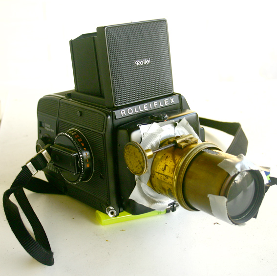

I absolutely LOVE my SL66E...
But I am strange - I have three lenses (50-80-150mm) for it, but rarely use them....
In stead I love the fact, that I can fit really old "crappy" lenses on it, due to the bellows.
A small petzval stuck in a cardboard, and fixed on the camera with duct tape....
Or a small landscape meniscus type lens...
Not many Mf cameras can accept those lenses so easily..

How the landscape meniscus lens contraption looks....
Addictive!
