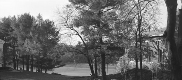

I made a mask for the film that is basically a 6 by(not quite)14 format from aluminum flashing, cut from a roll so that it has a certain arch to it. I then hot glued a few fiber washers to the take-up reel to center the 120 film as it rolled through. A plastic reel from 120 film, cut in half and placed inside-out as spacers for the end of the camera that takes the new roll and I was all set. The winding is a bit tricky, but I had a sacrificial roll of 120 that I ran through with the back off, marking exposures and counting windings. I don't use the camera much, but it is certainly usable and I have fun answering questions about it when folks see me haul out this huge folder and start shooting. "Pocket" Kodak, indeed! I would have thought that an unreasonable name if i hadn't owned an old wool overcoat from the 40's. The thing had pockets large enough to carry a laptop.
