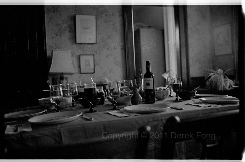

Not to hijack this thread, but I've been having similar problems. Here's a scan of a negative I recently developed. You can see the white spots across the negative (they extend across most of the frames of this particular roll), which appear as small, mostly-transparent specks on the shiny side of the negative. I have this happen to me VERY often.. usually a rewash + some massaging in water gets rid of some of the specks, but some are usually leftover and others tend to re-form the second time around.
For rinsing, I generally follow the 1+5+10+20 "Ilford" method followed by a dunking in some water with PhotoFlo. I've been experimenting with finger-squeegeeing vs. non-squeegeeing to see if that helps, but I always end up getting either milky stains (maybe PhotoFlo residue??) or specks after drying.
Help! :blink:
Are they always in the same place, relative to the margin of the film?
Pretty much, IIRC. Usually either within the top or bottom third of each negative. Almost never in the middle.
Look to your film hangers to see if they are retaining moisture or debris and dribbling it on the film. Also, make sure that you are using sufficient solution in the tank.
Hmm, I'll check for that next time. I use wooden clothespins to hang and weight my negatives, I hadn't thought that they might be causing the specks. Still, considering the specks go nearly the entire length of the film, I'm not entirely convinced it's because of them.
