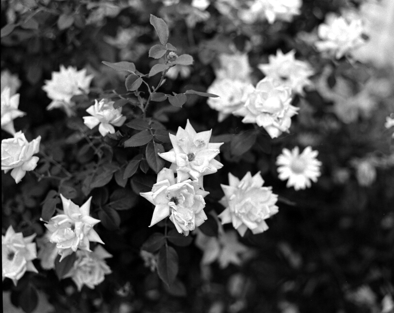

The Wratten A is equivalent to the Wratten 25 colour separation filter (not the darker 25A). My B+W 25 has a filter factor of 5 (2.3 stops).
Another use for it is when photographing red flowers against green foliage if you want the flower to come out light and the foliage dark.
