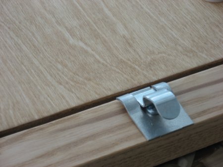

Had to take the day off from work, my kids started school and usually I get sick the first or second week into it.
So I'm just working away and UPS dropped off my contact frames from Formulary. It was backordered cause the guy who makes it had some equipment problems. But boy, these are really, really nice for the money. I can smell the new oil on the wood. In the back, there are clip springs (don't know what to call it). These are way better than the old ons I got from ebay that have those pressure clips that always cut into the wood.
Can't wait to use it! Guess I'll be "working" on my negs in the bathroom today instead of real work.

Congrats on the frames! Perhaps a pic or two when the bug passes (ahem!)?
Isn't it wonderful how biologically "active" kids can be when in contact with each other? :wink:

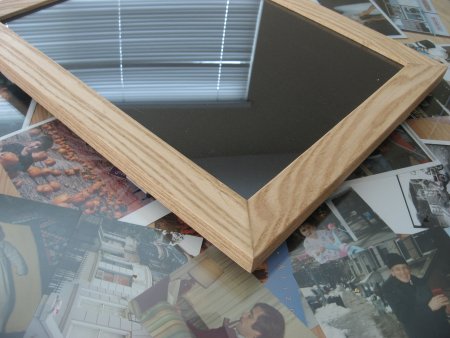

Pictures? Sure!

Interesting; never seen that type of clip on a frame. Let me know how they work, would you?
