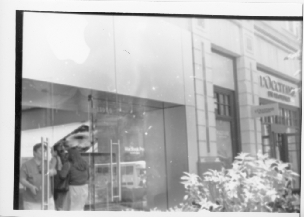

I got a proper safelight so I decided to give it a spin and tried to make prints. Well, success! I got images! They're not great but they're there. They're a bit soft and I still have to tweak the exposure but I was thrilled to get something. I also need to get a darkroom timer as while my watch works fine for developing film it's useless for printing. Thanks again for the help people gave me over the weekend!

Thanks guys...OK...here's the proof.(it's not very good....like I said..I still have to work on stuff but is is an image)
That's wonderful. Congratulations!
As to being satisfied with the results... you will never be.
That's one problem with this addiction. You can always figure out ways to improve any image. :D
Enjoy.
- Leigh
