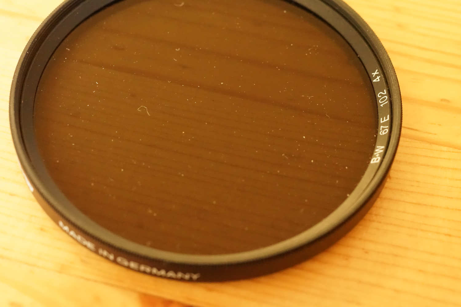

I found a couple of second-hand B&W ND filters from this series a while ago and have been getting on well with them.
However, I've never had any inhibitions about taking my black and white or coloured photos with filters. On the contrary 😉.
