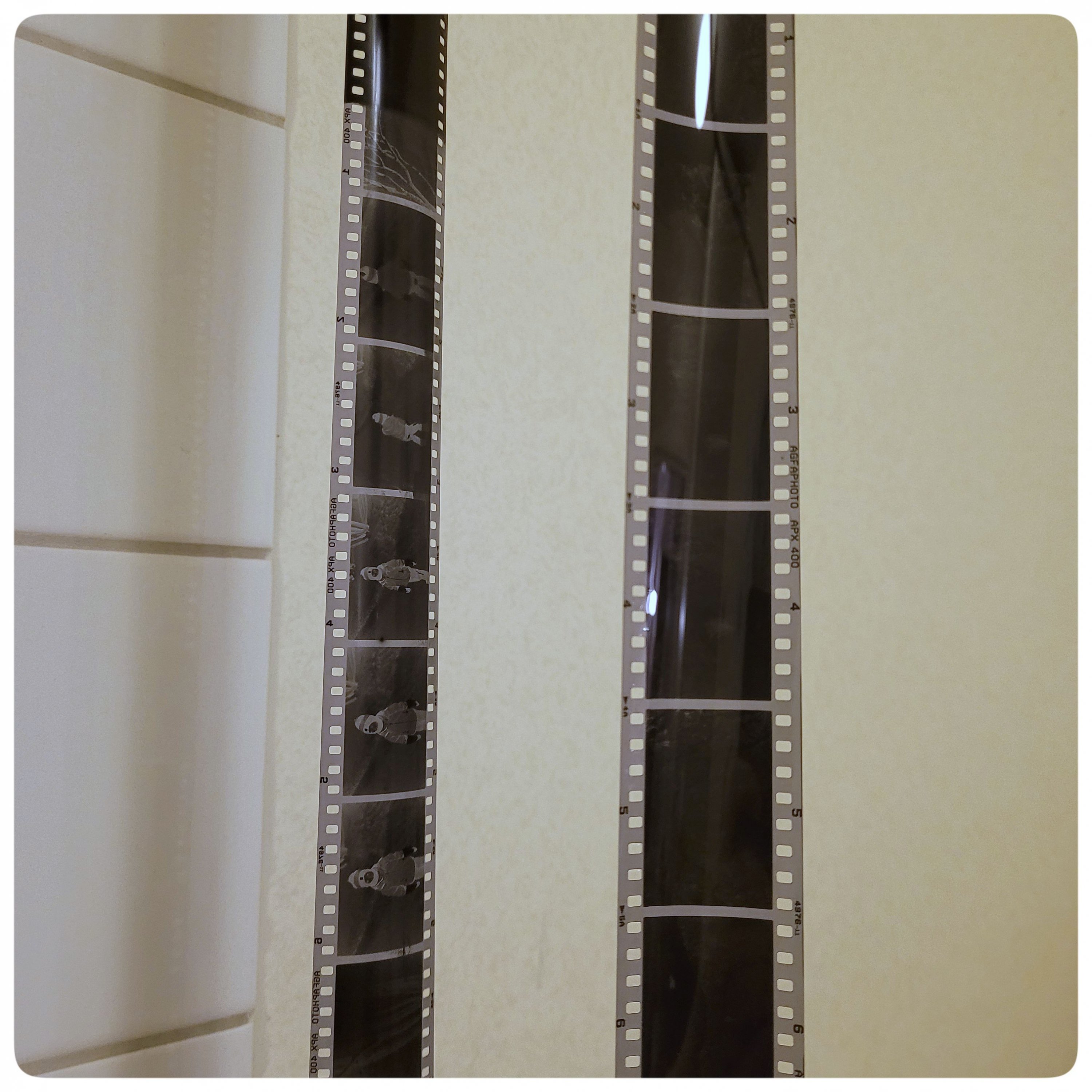

Hi, I found my old chemicals. There was also ~80 euros worth of expired large bags of Xtol developers. Stored in warm, couple of winters in freezing temperatures. The dates were 2013, 2015 and 2017.
Should I just dump them or make a test with one of the 2013 bags and if it works, just use it quickly? I would of course test all bags separately. Is there a risk of the Xtol sudden death? The chemicals feel normal inside the bag. They still feel like powder, no clumps etc.

Mix the oldest. When the compounds in the two bags are not clumped and brown, but the pale powders they should be, you will probably be alright. To make sure you can do a test of course and when that works out well, it will be as good as ever.
MARTIE
Oct 31, 2004
271
I would keep them and just do a leader test, at dilution, before each and every processing batch.
You're looking for the film to turn a decent black within a minute or so. Anything grey, I'd dump the lot of that batch.

Test a film leader. I have had good bags that were older. All you have to loose is a strip of film.

The use before dates aren't magical - they provide an indication of how old the product is, and relate as much to the expected integrity of the packaging as anything else.
It would be prudent to set up a test target that you can duplicate in the future. Expose and develop one film in known good developer, and then keep the negatives for future comparisons.
If you don't have known good developer, you can take a chance on the bag that looks to be in the best shape, and see if the result is well developed negatives.
From then on, whenever you open a new package, use it to develop a new film exposure of the test target. Check to see that the new stuff is giving good results and, if so, use it.

The 2013 Xtol worked just fine. Thanks all!
