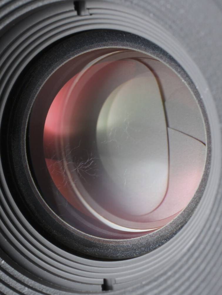

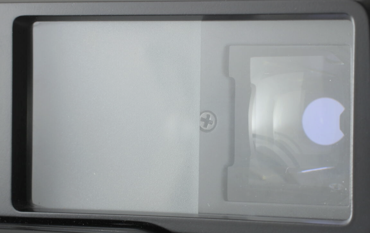

I found a good-looking Fuji GS645S save for two small issues. Can I fix tiny lens fungus & a tiny bit of haze? (If that's what this actually is.)

The Fuji GS645S seller claims that the camera is practically flawless, save for what he calls is fungus on the lens from elementand a tiny bit of haze on the viewfinder.
Here’s what said about the [viewfinder] and the lens:
-Finder:
Beautiful condition.

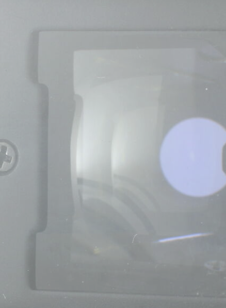

There is a thin haze.<----------------(I can't find this "thin haze. Can you? If there is indeed some haze in the viewfinder, how can I safely remove it? )
There is no fungus.
There is no balsam separation.
There are no scratches.
There are no large dusts.
No problem in the view.

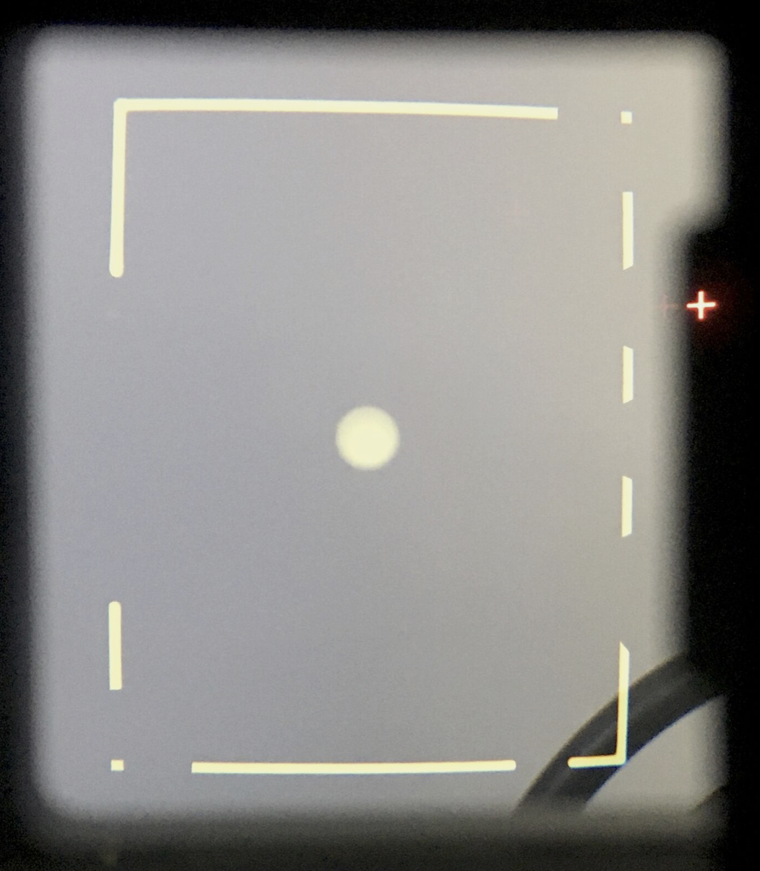

Here's a picture of the viewfinder:
Here's a picture from inside the viewfinder!:
-Lens:
There is no fog.
There are a few tiny fungus on the front element.<-------(There is obviously something going on in this lens. Can anyone identify it and tell me how to fix it?
No problem in the shooting.
And here's a picture or the lens:
Are these two problems repairable? If so, what tools, chemicals, etc. do I need to fix them? Of note, I do have a substantial amount of repairing cameras, nut not particularly in the lens/viewvinder department. Any help on this would be greatly valuable!

The description sounds typical of a Japanese eBay vendor. I have had not great results with these vendors. The almost always overstate the quality of the goods and/or minimize defects. I've also had several instances where the item went through some kind of in-house "repair" and was not operating properly when I got it.
I have never had problems getting refunds, though.
I'd run away from this one.
You can check with Fototech in Warsaw, Poland to see if they service these cameras. They fixed my GA-645Zi really nicely. Be aware that shipping is a killer though, if you live outside Poland.

They fungus may or may not be possible to clean by disassembling the lens. Its growth can likely be halted by exposing the lens elements for an extended period of time to strong UV light. The fungus as shown here will not affect image quality in a perceptible way. In due course, fungal growth like this will permanently damage the lens surface. Even cleaning won't remove it. If this is the case with this particular lens is impossible to tell at this point.
The haze in the viewfinder I find impossible to judge in terms of severity. It's likely that it can be cleaned and this generally requires the camera to be partly disassembled.

Recommended tools might include:
Rubber cups for unscrewing lens beauty rings, optical cells (Japan Hobby Tool et al)
Miniature screwdrivers, particularly JIS-type (Vessel et al)
Lens cleaning fluid, or if there are greasy spots, sensor cleaning fluid
Misc: Lens tissue, cotton swabs and/or microfiber cloth.
If you've never cleaned a rangefinder before, be extra careful, as you may be dealing with front-surface mirrors, and in some cases, frame indicators which are painted or vacuum-deposited, and these are easily damaged.
Although I was very fond of Fujifilm's pro cameras when they were new, I hesitate to purchase them at 2023 prices, partly because I don't think they were built to last. But if sufficiently cheap, it might be worth the gamble.

There is a plethora of these cameras on Ebay. In the end, the lens is the heart of the camera. There's maybe $100 difference between one with such issues and one without issues. Fungus often etches the lens. If I were set on this camera (and they do have some great features), I'd buy a top notch one.
Chuckroast, I've had nothing but good results from sellers in Japan. Often there are many photos, the shipping is fast and modest in price or free. I have no doubt that the descriptions use some form of auto-translation....but it's pretty easy to sort the cameras by issues or lack of. The biggest advantage is the huge supply of cameras in Japan. Over the years, I've bought a number of cameras and lenses both on ebay and in person, on visits to Japan. I much prefer this to the KEH sales model where you have a good return policy, but a general grading and no photos of the actual item you're buying.
Fuji and others have made some great cameras. I've been especially fond of Plaubel Makinas and the terrific mechanical GW/GSW Fuji, but always hesitant about the electronic versions like this Fuji 645, or the new Mamiya 6, and Hasselblad/Bessa Xpan which could turn into very expensive irreparable bricks.

Sound advice on every point. The Vessel stuff can be hard to find and/or pricey. JIS can be found here:

I've worked on a GS645W and removing the top cover or the lens cells is like most other cameras. Watch out for the sync cable, and the conical bezel is likely glued on and easily marred.
Haze and/or fungus can be a crap shoot. Sometimes it wipes off trivially, sometimes it is etched on.

clean fungus with damp(not wet) with 3% hydrogen peroxide(H2O2) then clean with alcohol.

I bought a Fujica GS645 from Japan a couple months ago that was supposed to be pristine with new bellows. After I shot a roll with it, I found that there was some sort of light leak. The seller offered to refund the cost of repair if I wanted to send it to my local repair guy. I debated for a bit, but finally decided that it would get really messy if I sent it for repair and it couldn't be fixed. I ended up just sending it back. The seller refunded my money and I found another for a similar price that has worked flawlessly ... so far.
I'd recommend looking for another.

If a repair person can remove the fungus, the coating may be etched. I do not know if the glass gets etched. But so what? Maybe you will see a bit more flare in some circumstances. A hood will mitigate that most of the time.

that much fungus should just wipe off with a microfiber lens cloth, but i doubt you'd notice any loss of image quality if you just used it as-is. as long as you don't store it somewhere humid it won't get any worse. don't waste your time trying to sterilize it with uv or any other nonsense.
