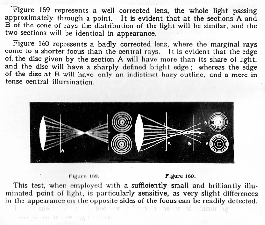

Bokeh* as I understand it is a function of the way spherical aberration is corrected, or not - The following chart is the best description of Bokeh I have yet found - It is from the 1897 book by Conrad Beck
However, a modern aperture will give a funny shaped circle, but as good bokeh is considered to be smooth with circles of out of focus light shown without a harsh edge that becomes less of a problem - When looking for lenses for LF the OOF zones are a deciding factor in my decision, one of the reasons I like my Heliars**
* "Bokeh" is too trendy a term and like everything else they name the Japanese did not discover or invent it, proof of which is the Beck illustration
** The failings of Heliars is subject for another discussion which I am sure has happened in the past - To me it is a problematic design which perfectly suits some subjects - I do not use my Heliars for landscape photography and prefer my better balanced Skopar, Xenar and Ysarex designs

"Highly corrected" does not imply good bokeh at all, it just means that spherical aberration is well corrected. As it happens (over-)correction of SA tends to cause terrible bokeh and some of the prettiest bokeh you'll see comes from lenses with severely under-corrected SA. The SA causes the edges of the highlight discs to be softly rounded off; exactly correcting for SA results in sharp-edged bokeh and over-correcting SA (a common approach to getting a bit more sharpness) results in nisen-bokeh, i.e. line doubling because the edges of the highlight discs are brighter than their centres.
If you want the ultimate in bokeh, you need to use an apodisation filter by the aperture, e.g. Minolta's 135 STF.
Hang on, what I actually typed was "I understand it is a function of the way spherical aberration is corrected, or not" - I have added the bold type
