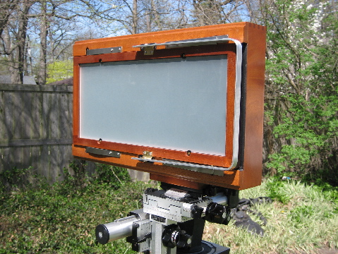

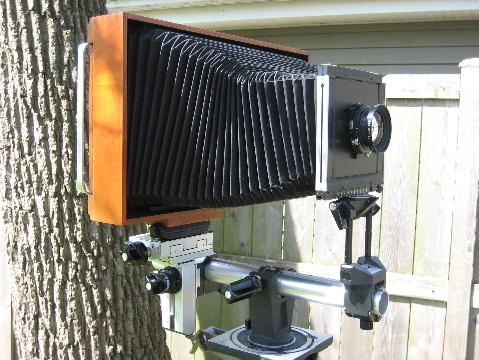

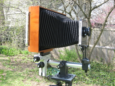

Richard Ritter got my Sinar to me with the 7x17 conversion about 10 days ago and then I had to send the rear mechanism to Precision Camera Works for a CLA. I at long last got it all put together last night and wanted to share it with all of you. I am very excited to finally have a 7x717 camera!
I need to do a couple minor tasks to improve it a bit. I want to add a velcro strap to the bellows to prevent it from sagging, and add extensions to the front rise posts so I can have more than about 1 inch of rise.

Nice looking camera Richard, but 7x717 is a hugh camera :D
LOL
Dave
Richard it looks great hope to see somthing in the gallery soon
enjoy
Kevin
Richard. nice setup. I like the looks of the Sinar/ULF modified cameras people have been doing. Cant wait to see the results you get from shooting with it.

Gosh, your camera looks nice! Please give us more specifics (min/max extension, weight, etc.). The precision geared movements on the rear standard have to be sweet. Due to the long focal length lenses used on 7x17, it will make the camera MUCH easier to use. I won't have any geared movements on the back of my camera (one concession I made to keep eth weight down), but I did opt to go with self-arresting geared rise and axis tilt on the front. That way I won't need a third arm to loupe the ground glass while applying tilts.
Congratulations on your new camera. In terms of usability and rigidity, it should blow away just about anything out there - certainly better than a wobbly old antique that would have probably cost you more money. What a great way to move into ULF.

Thanks, I too think it turned out very well. The camera has a minimum of 5" and a maximum of about 32" of extension. It might have a bit more length, but I ran out of rails. It weighs 13 pounds without a lens and is very, very solid and rigid. I don't know how much front rise I will need either and am thinking of adding 3-4 inches which I think has to be more than plenty. I'm assuming that because of the panoramic aspect that I won't need too much rise, but time will tell.

Wow, 13 lbs. is great for such a full-featured, rigid 7x17 camera. Given the weight of a stock 8x10 Sinar P, I would have expected it to be more. David Robert's 8x20 Sinar conversion weighs 24 lbs., but it's an 8x20, uses a Sinar P front function carrier and has two rail supports and an additional base plate. I think your combination of P rear function carrier and F2 front standard gives the best combinatiopn of usability, rigidity and light weight.

Yes Richard, that is a beautiful but very large camera. Enjoy it. How small does it fold down and how far do you think that you can carry the camera into the field?
