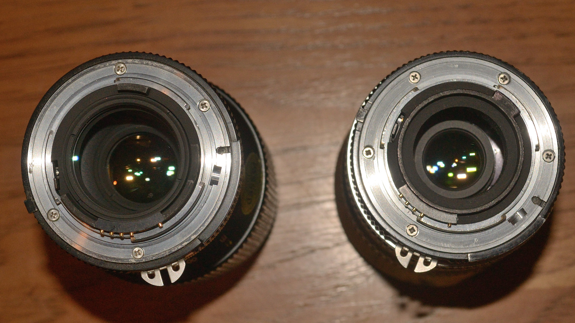

Looks like those attached with very little or no modification. Which lenses are those?
Left is 50-135 f3.5 Ais. Right a 25-50 f4 Ais. I have a 24 f.2.8 Ai too. Been difficult to get the chips since the war but I've got a few more I wanna do. Autofocus has it's place but I prefer old Nikon manual focus glass. Many lenses don't require anything other than attaching the chip. If the rear baffle diameter is from 1.355" to 1.426" likely it'll be fine. Some lenses just aren't worth it, either value or effort. Programming the chip is easy. I use my D90.

He he, that's pretty slick.
But:
- Where are you getting the chips?
- How exactly do you know where to mount them?
- Do they not have to somehow be programmed with the required lens info? How is this done exactly?
1.)Ebay...from Ukraine.
2.)They come with a jig that places them.
3.)You can program them with most digital cameras. It's a bit daunting at first but after a time or two becomes easy.
I like it 'cause it opens up all modern camera's features including matrix metering. Even focus lock if you use that. I don't care for it but it can be handy. I started for my F5 but found it nice for the digital units too.
And check this guy's blog out. That's where I found out about it. Used to be a guy who did it for you online but he's gone. They come with pretty good instructions but translation is muddy in a couple spots.
