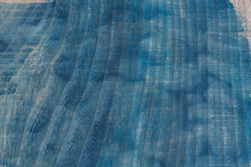

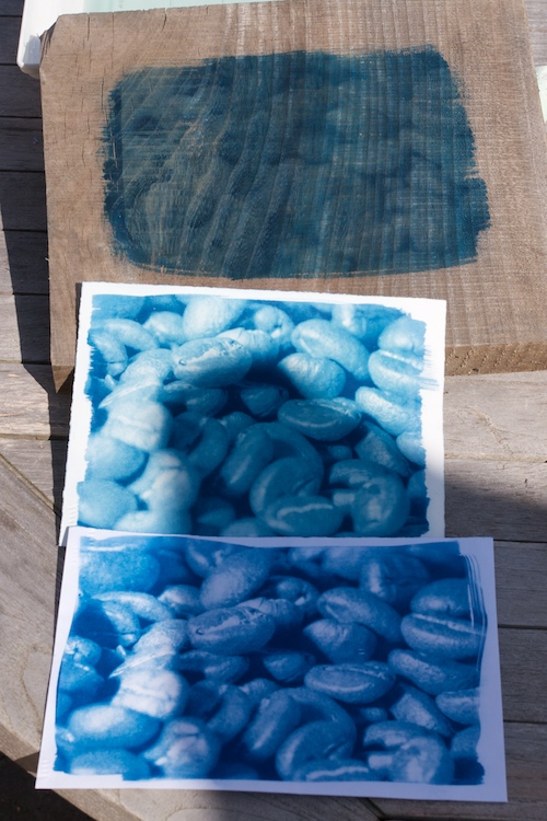

Pictures
Here are two pictures. One shows a closeup and the other shows the same picture printed on wood and two different types of paper. I dont have a scanner. The cynotype on wood looks much better in real life. I am sure that it would be even better on a polished piece of wood.
In this test I coated the wood with a gelatine/water solution (10g gelatine from the supermarket in 1 liter of water). After letting it dry, I coated with the cyanotype, let that dry in a dark place. Placed the neg on the wood and covered with a plexiglass plate, exposed in the sun. Washed in running water. Let it stand in the sun and rain for about two weeks and now it looks like on the picture.
The picture shows my favorite coffee (beans) - Finca Vista Hermosa
