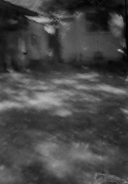

Couple weeks ago I posted a thread asking how to develop a roll of 116 film i found in an old camera (Kodak 2C)from a garage sale, without a tank. I finally did it just now. It's still drying yet.
After reading everyone's comment I decided to do the following. I used a medium size empty butter Tupperware thing-a-mc-git.. Fill it 1/3 way with Straight D76, turn off the lights in the bathroom, and use the seesaw method. That was something else I tell you. Seesawing a roll of 50+ years old film in the D76 for about ~15 minutes, then, wash, then fix. It works, but its a total different experience, and very uncomfortable seeing i am sitting on the floor outside the bath tub.
For the record, before I did it I was concern about the film being all curled out and would not stay in the developer, and won't allow me to "seesaw it". Found out that is not a problem at all. The film stays at the bottom pretty well with the developer pushing down on it and the film sticking to the side of the tub while its wet, of course not the emulsion side.
Now you must wonder what is on the roll?! Sorry to disappoint you, The roll appeared to be heavily fogged. However, i can still tell all six frames are there. But, I cannot make out what I'm looking at. I think over the years it all turned into a random fuzz.
After it's dry I am still going to scan it and see if i can make anything out of it at all. I can post them later if anyone is interested.
Before I go, once again, that seesaw method was truly something else, I can't imagine doing that all day in a lab. It was truly a learning experience.
At least you might have a few images that are printable. For a film that old it is a good result.
Thats pretty much the only usable image that shows up. It is blurry, but at least I can tell what it is.

It's commendable what you did, it's just too bad that the previous photographer sucked.
:sideways:
Actually, it's sort of an 'arty' picture. Print it, hand color it, stick it in a frame and hang it on the wall. Folks will love it.
Nice effort Dehk, sorry more did not come out.
I got lucky with my 116. 5 of 6 photos came out. There were pinholes in the emulsion and it was fogged but scanable (er, printable) and we got to see the pictures. It's fun to see what's been lurking inside that box all these years.
