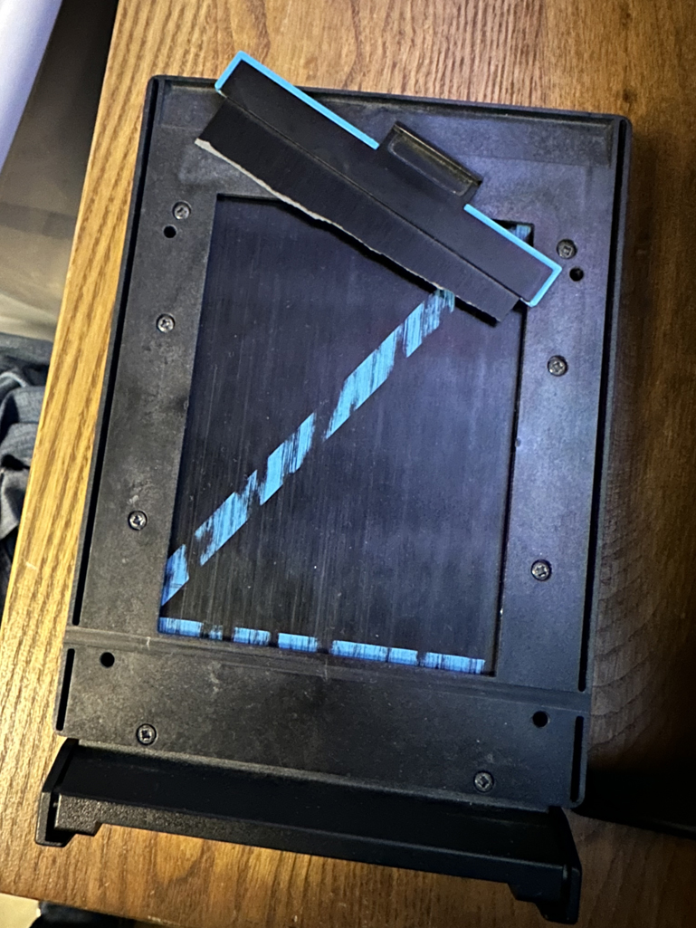

I don't really know the right name for the back. It says Polaroid on it but that's it. It works fine with Fuji FP100C, which is what's currently in it. I still have about 5 packs of the stuff and was hoping to use it up. And then I broke the dark slide. Nothing else that I have seems to be close enough in size to work. Any ideas for an adapt and modify job? Or what the name of it might be so I can google away and find one? I'll probably try to tape it together, but I don't have high hopes. It broke sorta near where it comes out of the holder. TIA

Likely true! I just need to know the key word to find one (I don't know what it is because I got it for free - no box or info). My first quick look didn't get anything that looked like mine.
Ok, I finally figured out - I think it's a 405. And the prices for them that I saw in search #1 ranged from $50 USD to $190 USD. Way out of my range to just get a working dark slide.

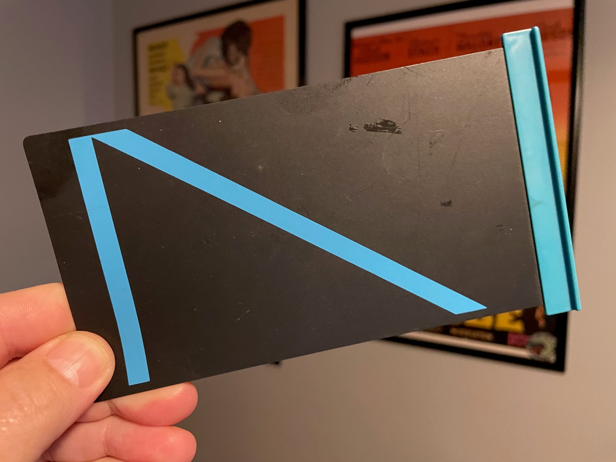

Does it happen to look like this?
Kino
Jan 20, 2006
7,763
Orange, Virginia
It's 3 7/16ths inches wide and 6 1/2 inches long including the blue pull handle.
I've had it in my junk drawer for years. Pay for shipping and it's yours...
You seriously ROCK! I haven't measured mine, but it must be right. I'll pm you my address. Let me know how much shipping is.
