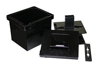

I bought this because I think it's neat. I've never used it. I always assumed you poured in through the hole and poured out the corner while holding the lid on. If it was me I would fill the tank with developer. Then, in the dark, load your hangers, then drop them in and put the lid on. Then you could turn on the lights. The old Kodak slosh back and forth works just fine same as with the FR and other similar designs. This really appealed to me because it takes fool proof Kodak plate and film hangers. I've never developed a glass plate but the Kodak hangers (and Carr etc.) are designed for both . All you need is a thermometer and a timer and you would be set. This picture shows 10 hangers. I'm not sure what it was designed to hold but I think having it comfortably full of hangers even if some needed to be empty might help keep things from scratching (Just a guess)

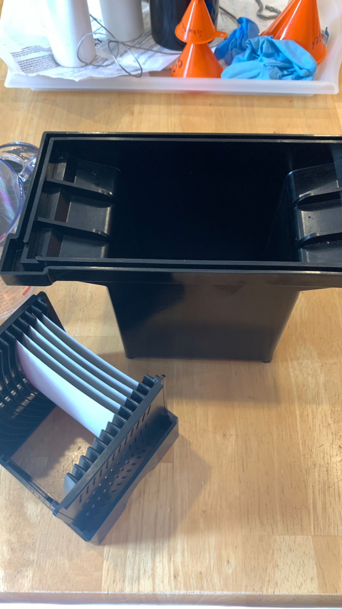

I have one of these tanks in all-black. It came with an insert for 12 4x5 film sheets. The hanging plate holders could also be used.

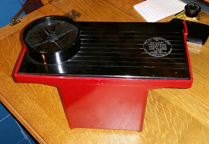

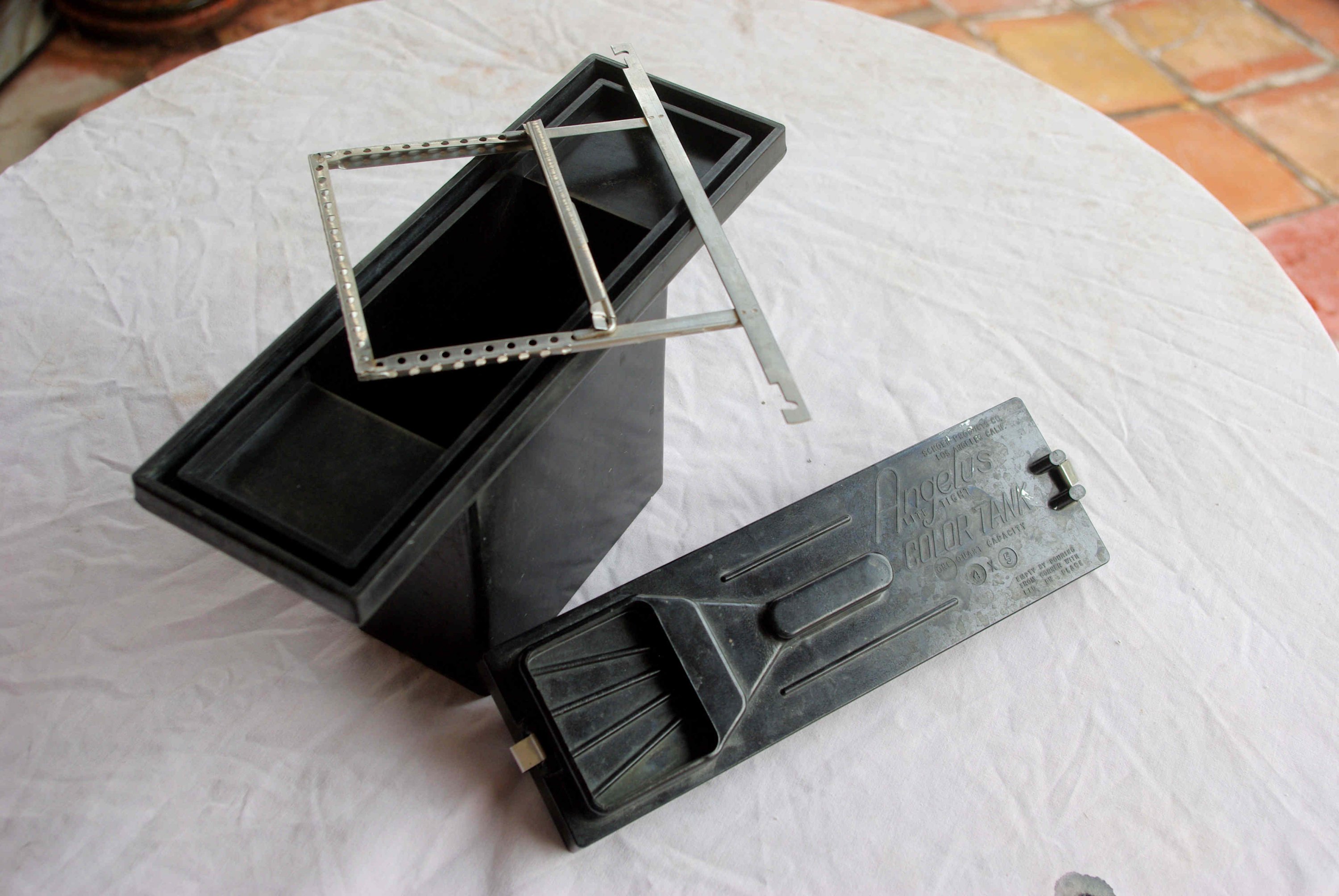

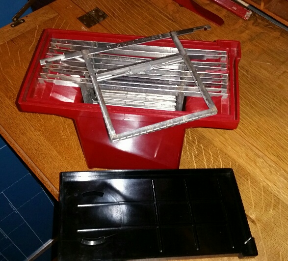

I have a set of 3 tanks very similar to yours. Mine are smallish side, takes a quart of chemistry and will hold up to 5 hangers. I usually don't use them as a daylight tank, I develop in the dark, agitage by lifting the hangers out of the chemistry. When I do use them as daylight tanks I tends towards a developer with long development times to prevent uneven development, I timedhow long it took to empty, about 30 to 40 seconds. If you have a dark room you can turn off the lights to fill and empty the tank which takes much less time than pouring though the lid. My set was marketed as color developing tanks, which made sense in the day as color chemistry must have been very expensive and needing only a quart must have been a savings.
