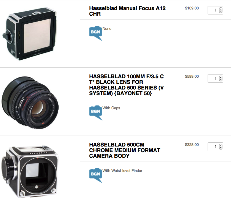

1. Is the C T* 100mm better than the CF T* 80mm?
2. Would I be better off buying BGN rated get from KEH, and getting the 100, or a whole kit that looks to be in great condition from a member with good feedback on a forum but getting a chrome 80mm lens?
I appreciate all help, comments, and guidance!
Here is what I have in my cart. Is there anything else I need. If so, I may need to drop down to the 80mm to keep it as close to $1,000 as I can.

You don't want an ultra sharp lens for portraits, trust me. The older, chrome 80 would be great, but you won't get head shots w/ it. I wasn't crazy about the bokeh on my 120 lens either. Maybe get the 150 and the extension tube, or live w/ the focal length limitation of the 80 and crop. The chrome 80 is really good, and while it's not ultra sharp, it has great IQ. Truthfully, you can save yourself a lot of money by going to the Bronica system, and I saw essentially no difference in photo quality compared to my 'blad.
Have you ever shot one of these? They aren't everyone's cup of tea. Large, difficult to hand hold w/o a grip, heavy, and have a particularly loud, flappy shutter. I found TLRs a lot easier to deal with for medium format. If you're primarily using yours in a studio then none of this will matter, but on the street, a 'blad is not that much fun to shoot. A Kowa w/ a 150 would be a bit more doable.
I finally went to 35mm gear for portraits because it's so much smaller and lighter, and a good Leica R 90 lens can give you very large prints. The Canon FD 85 1.8 is pretty special for portraits too. Both lenses allow you to stand far enough away from your subject so that you don't bother them. Just my 2 cents.

I now have the following in my cart at KEH:
- excellent condition chrome body with finder and rapid winder
- bargain 80mm CF T*
- bargain A12 back
- bargain 150mm C Chrome. I would love the vocal length and it's $144. I don't know though.... Tell me more.
OR should I just split the difference and get a 120mm CF T*? Instead of both those?
OR OR just the 80mm and a good focusing screen? Suggestions?
And with all that I've pretty much stretched my budget to the limit.

About the body from KEH, make sure it has both a focusing screen and waist level finder. The picture shown doesn't have the finder shown and they(KEH) sometimes don't include them with a body.
The C lenses also use the EV system where f stop and shutter speed are linked together. Some people like it, some don't. The CF have separate rings and may be more comfortable.
