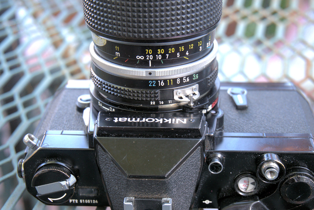

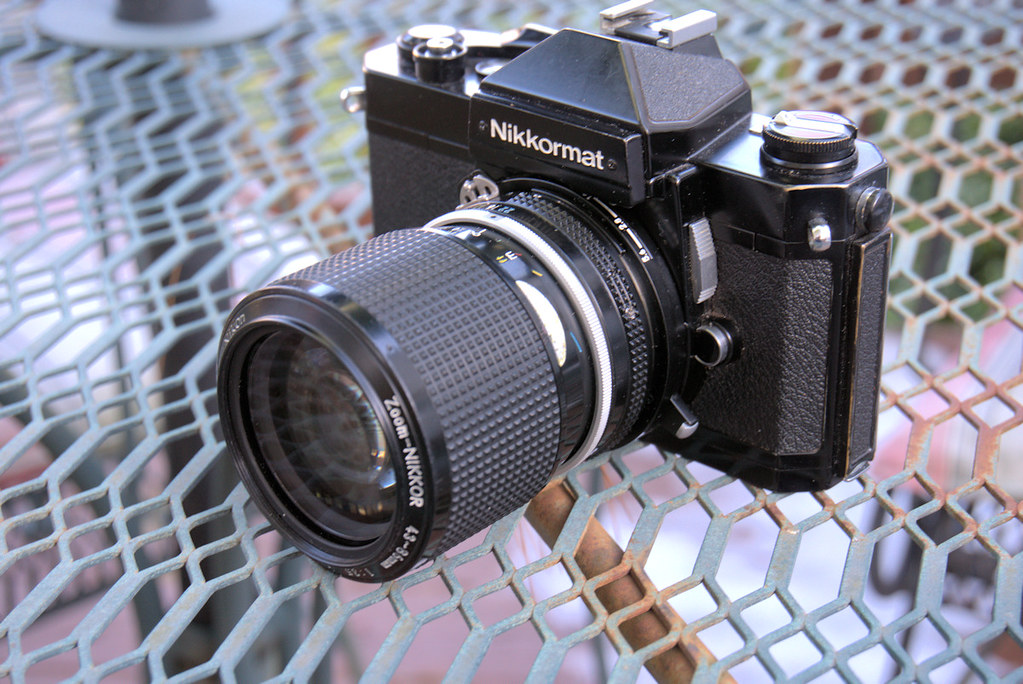

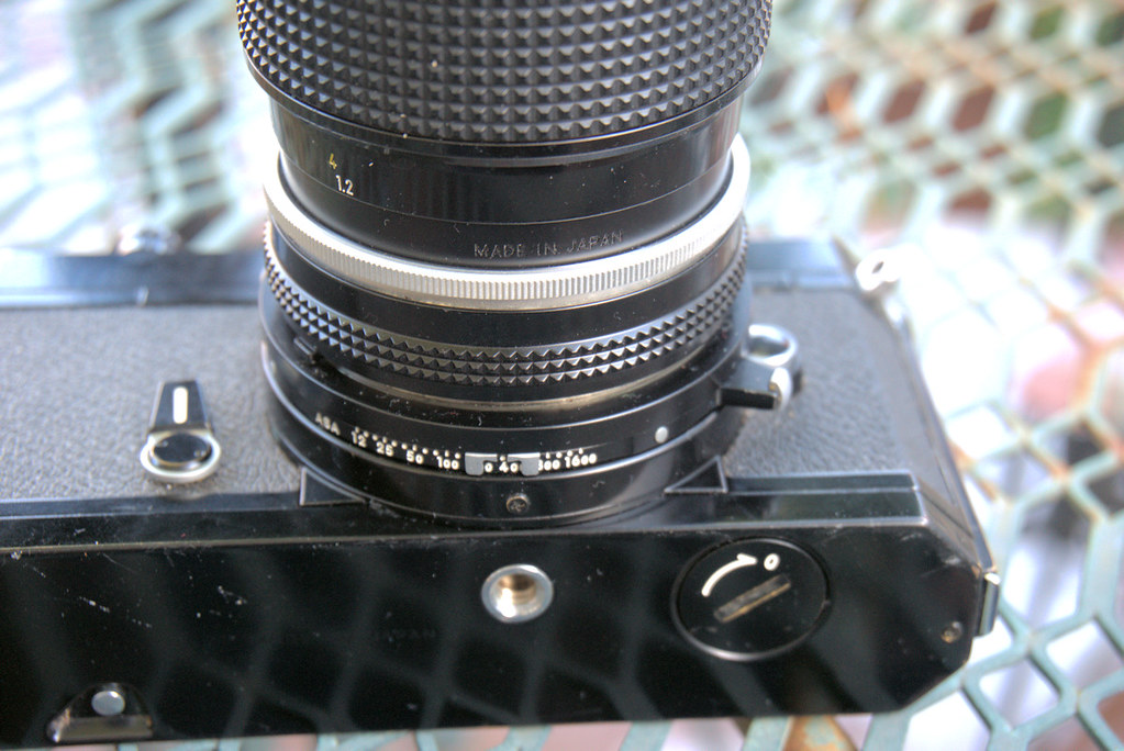

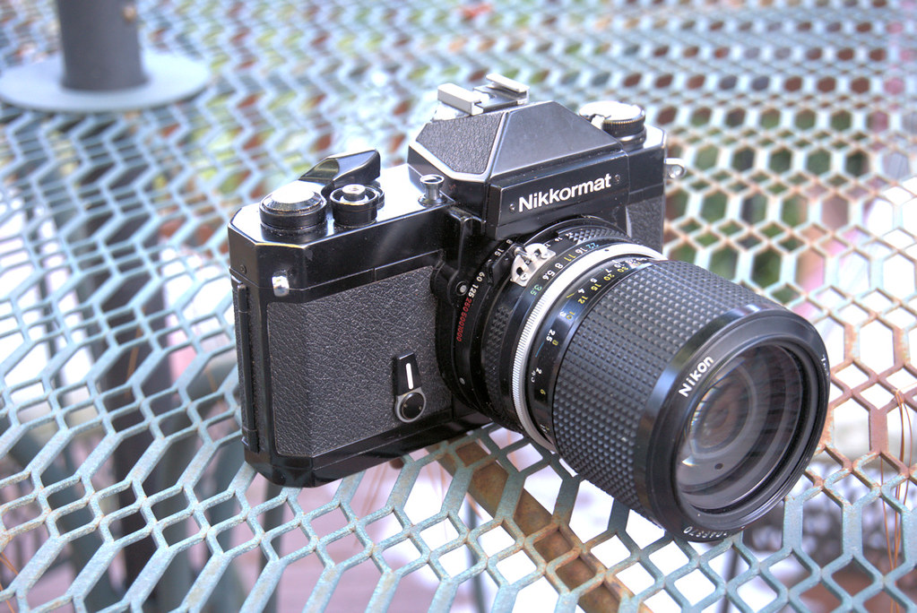

I was doing some spring cleaning, arranging some cameras, when I mounted a lens on my FT2 (pretty nice black one). I only have used Nikon cameras a few times, so maybe I am just inexperienced, but somehow I managed to jam a lens on my FT2. I thought I was indexing the thing, but it only moves from f11 - f22 and I cannot remove it from the camera. The lens in question is a zoom nikkor 43-86mm (2nd generation). Would it help to take the rabbit ears off or is it a repair best left to a repair person? The camera seems okay otherwise but I'd rather exchange lenses on it now an then.

I can't figure out what's wrong. In your photos, the lens is set correctly at f5.6. From there, it should just twist off. If it doesn't, yes, take the ears off, because I guess there's a possibility the indexer might be jammed or otherwise hanging up.
