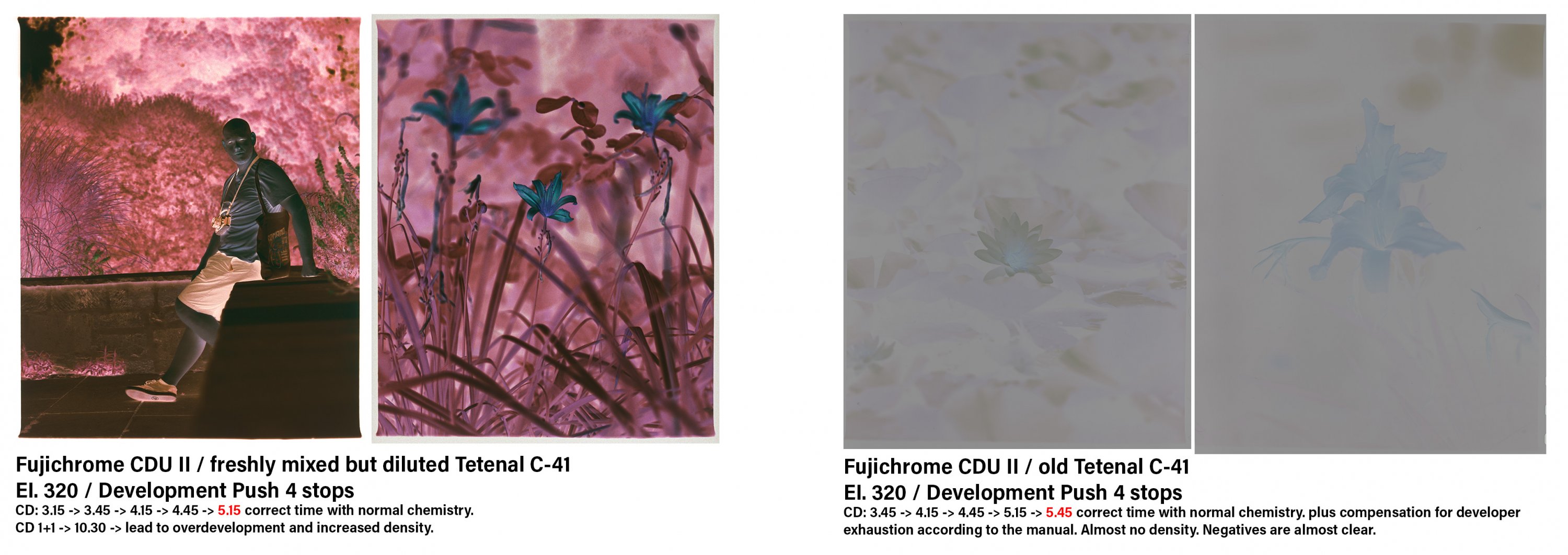

Back in the darkroom, I took the film out of the cassette and cut it in half to develop 2 strips in approximate 220 length, because I lack a reel that fits a whole length of 50 exposures (I use a modified Jobo reel to accommodate the extra width of the 70mm film). After having developed the first half of the film I was shocked: My color chemistry had seemingly gone overboard - judging from the almost clear negatives with next to no density. To be fair, the chemistry was on its last leg and I decided to give it a try, because the images were not that important and wouldn´t have been a huge loss.
After having disposed of the old batch of chemistry the next problem arose. Due to a prior mixing mistake I didn´t have the necessary amount of fresh CD concentrate for 500ml of working solution. In the end I tried to develop the film with diluted developer and compensated with prolonged development. CD working solution dilution was 1:1 and so I decided to double development time. This resulted in quite overdeveloped negatives with high but managebale density.

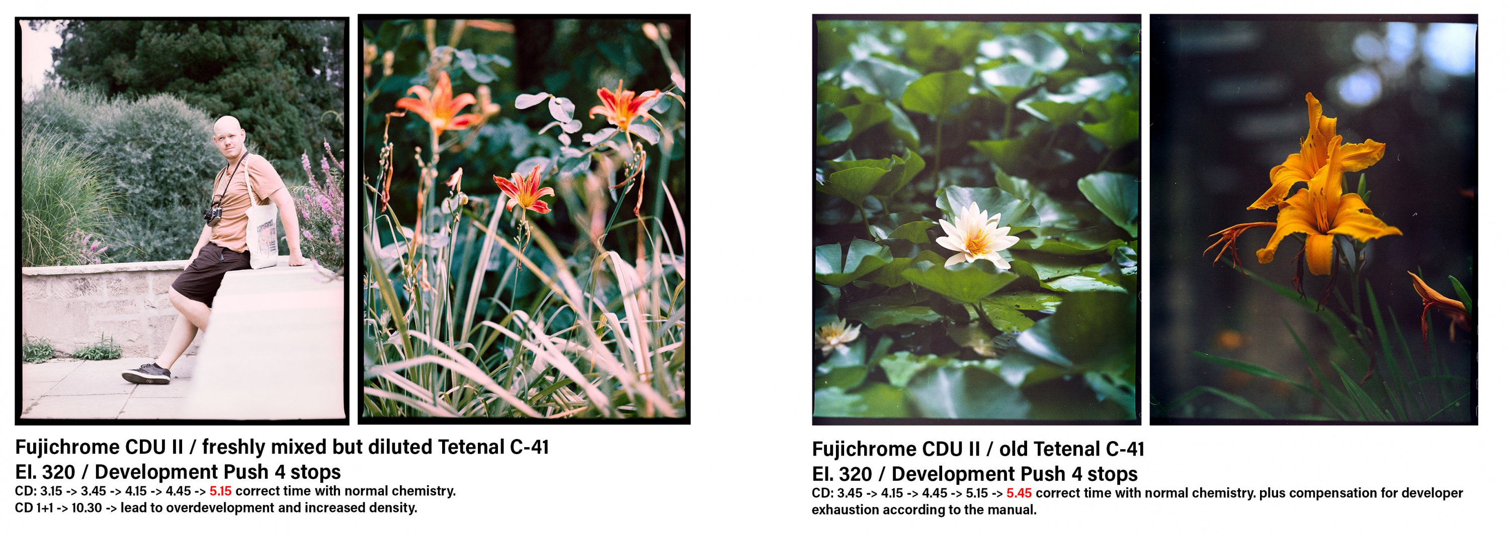

The overdeveloped portion of the film is grainy - as expected, super contrasty due to the overdevelopment and without a striking amount of detail. Everything nominal - kind of.
The really striking development (sorry for the joke here...) is that the practically undeveloped film has better color, better detail and less grain. Obviously, density is problematic, but apart from that.... Have a look.
(the reason for the amount of dirt and dust on the underdeveloped negatives is that I thougth they were unsalvageable and just tossed them in a drawer after drying, only to get them out there out of curiosity how bad they really were. Also, I didn´t care to clean them yet.)
The images on the right are clearly underexposed/underdeveloped, but have more neutral colors and a lot more detail. See crops below.

Can anybody help me draw conclusions out of this accident ridden mess on how to improve development and expsorure for this very film type since the degree of detail in the underdeveloped shot must be reproducible with correct density ?

Like many others here, I am a huge fan of "fat negatives", those in which you can see normal (for humans, not for photographic paper) contrast, with Dmax well above 2. At the same time, there's countless photographic literature calling for comparatively low contrast negs, with a Dmax below 1.0. Your sample scans may just be persuasive evidence for why this advice is good. Note: C-41 is an even lower contrast process than B&W, so whatever I just wrote applies to C-41 even more.
