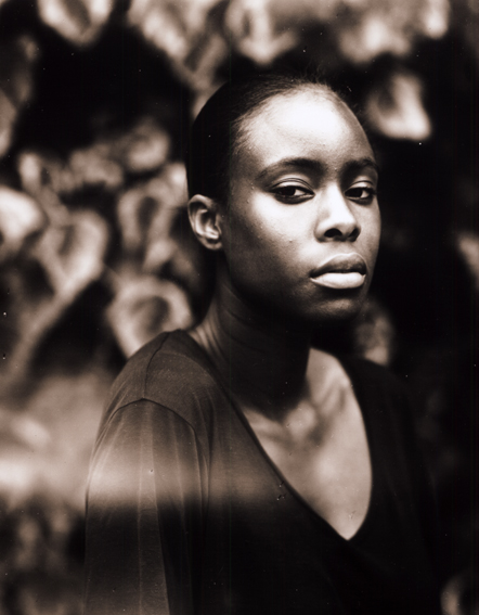

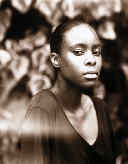

I use it a fair bit. Painfully slow if the temp is low, and I've found on some cold tone papers it can have a bit of a dulling effect even though it gives a warm tone, but on multigrade matt its great. Also with most warm tone paper. Can small a bit.
we use it in a tray bath of hot water about 120 degrees, and it does smell. It is slow even at 120 degrees, but for some images it is worth the time.
Ilford Warmtone. 10 and 15 minutes in toner.
Thanks Guillaume, when I first used IT-2 there were no warm tone papers readily available in the UK, I used with Ilfobrom and the results were purplish.
Ian
