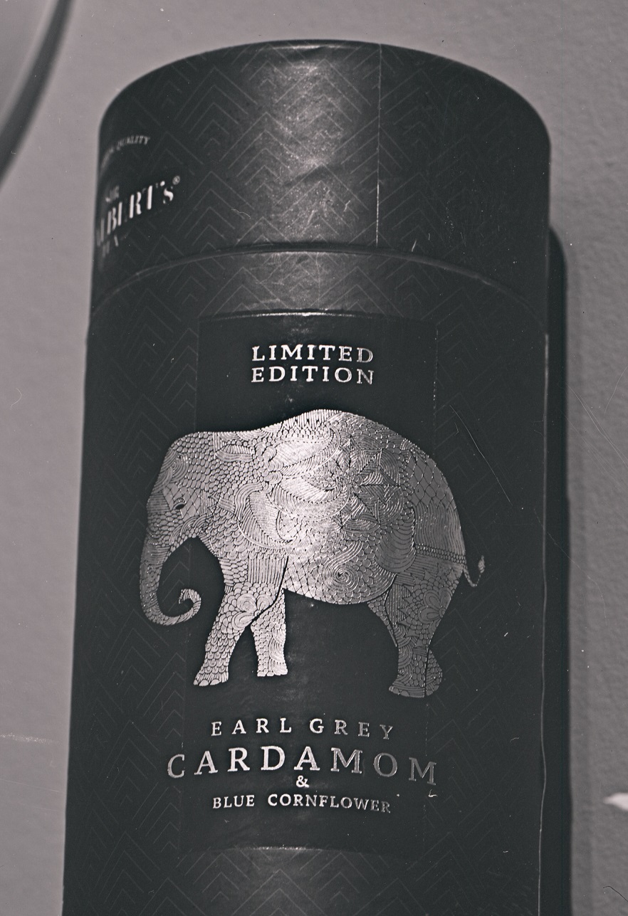

Nevertheless, I did an experiment, using the SP810 tray (almost open tray), with this very simple recipe:
Water 300mL
Hydroxylamine hydrochloride 2g
TEA 20mL
Sodium hydroxide 1,5g
WTM 500mL
The film used is an ortho lith film (Wephota FO5) @ ISO3 developed for 3 mins (20C)
Feb 13, 2020
22
Gdansk, Poland
Very nice result @Fausto Saporito. Thanks for sharing. Looking at the pic you shared, I assume you observed no damage to the gelatin.
Thanks.
Exactly, the negative is without any damage. Maybe it's this kind of lith film, or the tray development because it's not totally close so the nitrogen can disperse. My next test is with a Fomapan with longer development times.

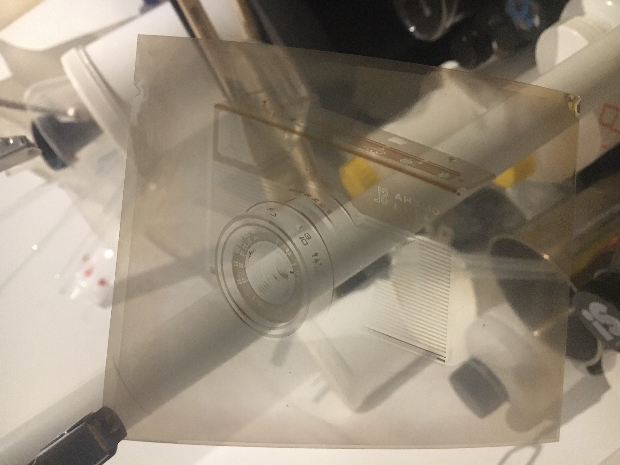

I tried a stand development, for 60 mins using 15mL of concentrate, so it means
Hydroxylamine 0,6g
TEA 6mL
NaOH 0,45g
in 500mL of water.
I agitated only at 30min for 10 secs.
The result is weird, and maybe it's related to the exhausted developer or the impurities in the tap water I used.
This is a mobile photo of the drying negative and because of the "transparency" effect of the FO5 film, is not so easy to see the image. But there is a yellowish/brownish tint that maybe is related to a spent fixer/bath?
Tomorrow I'll post a scan.
Anyway, I will try again with a fresh stop bath and fresh fixer.
Feb 13, 2020
22
Gdansk, Poland
