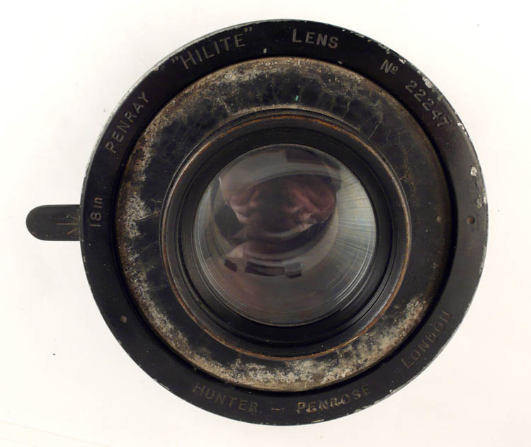

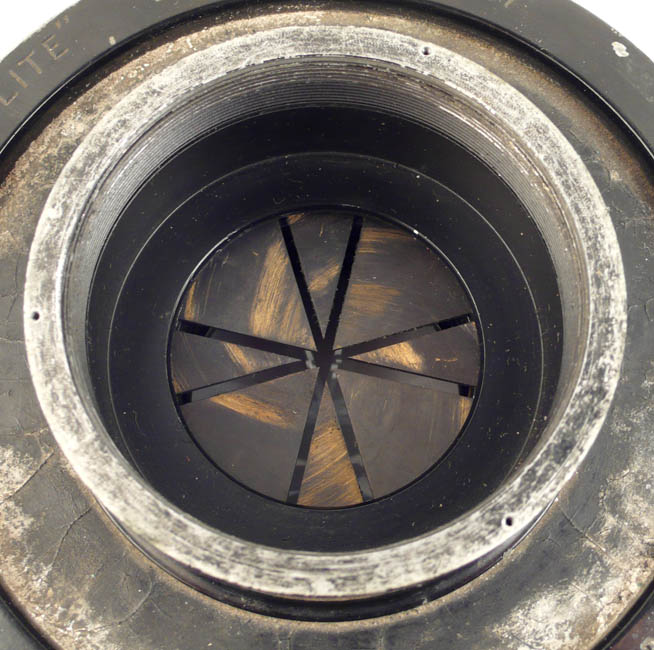

I don't, bu tI do own a very strange looking Hunter Penrose lens(Penlite), that properbly would have been sitting on one of those cameras...
(I was told it was a soft focus lens, but it surely isn't...)

Have you shot with it yet Gandolfi? A quick google search brings up your conversations regarding this lens.
gandolfi
Jan 28, 2005
1,820
Denmark
Large Format Pan
no - I have a HARD time figuring out the aperture system(s) (there's two of them....)

Gandolfi,
I don't know if this has been mentioned elsewhere, but many (relatively) modern process lenses were equipped with square stops.
The reason has to do with the nature of lithographic film--below threshold exposure, the no density develops; above that exposure, it goes to maximum density. A halftone screen produces dots which have smoothly falling edge brightness; the radius at which the brightness crosses the critical level determines the radius of the resulting dot and ultimately the average ink density on the printed page. Now, in theory, the dots are so small that the original image is reproduced arbitrarily well. In practice, because of diffraction (if nothing else) sharp corners are rendered as radii, and the halftone process exaggerates the result. A non-circular stop allows the effective aperture to be larger at some angles, thereby suppressing diffraction, while keeping the "average" aperture small enough to suppress lens aberrations.
The Penlite aperture looks to be a refinement of the square aperture, to allow vertical/horizontal and diagonal enhancement at the same time, probably to improve the "look" of certain typefaces. The need for this may be an indirect indicator of the overall quality of the optics---so you might just have a decent portrait lens there anyway
Incidentally, in the dim, dark, medieval ages of the electronics industry, masters for printed circuit boards and even integrated circuits were hand-cut from red plastic film, and to get uniform-width lines the corners were "filleted" on the inside and outside (a little notch at the inside corner and a corresponding point at the outside corner). This did more or less what your odd aperture would do; maybe the lens dates from that era (late 1950s through early 1960s).
gandolfi
Jan 28, 2005
1,820
Denmark
Large Format Pan
Thanks Greybeard. I haveheard something like this before.
I bought this from a very profilic and respected Ebay seller - a man with lots of lenses and always with VERY long descriptions on what it is....
This time he was wrong. I bought it because I beleved his words that it is a special soft focus lens...
(Fitting this on a board and focussing out side, I got VERY wierd bokeh - like small stars (which makes sense) so maybe it was a "Christmas Card Lens"....))...
So a copy lens it is - I think more from the twenties than the fifties ...
Thanks again
