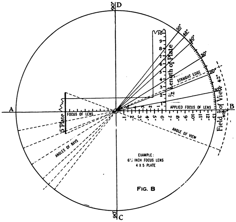

Angle of view for 4x5 film can be derived with a ruler and protractor. What is a 'crop factor?'
John Koehrer
Apr 3, 2004
8,275
Aurora, Il
Isn't crop factor used in relative sensor size with those other cameras? I guess it's pretty much the same as the Toyo
chart indicates.
