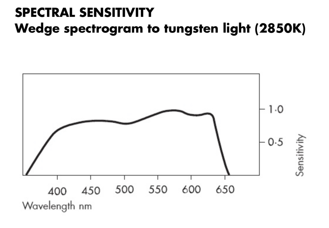

Looks like Aviphot 200 actually has it beat.
And not by a little.
Am I misunderstanding something?

Look at the log sensitivity. HP5 is sensitized for daylight.
Superpan 200 real speed is AFAIK 160 in daylight.

Tungsten loses one stop. High red sensitivity film shouldn’t lose as much. So by my “educated guess”, and by not looking at the curves, I’d say both films end up being equal or a slight edge to aviphot.

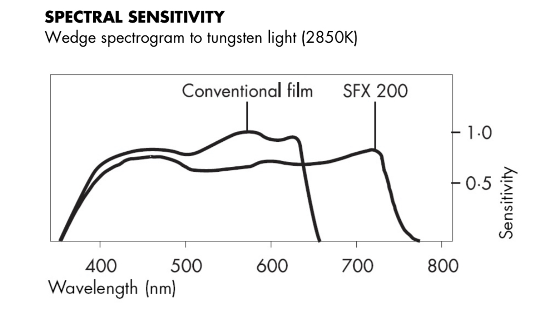

Had the “genius” idea of looking up SFX which is quite similar to Superpan (second is HP5 again for comparison though it’s probably the one in the comparison with the “conventional film”).
Ilford is definitely doing something different with the spectral response curve.

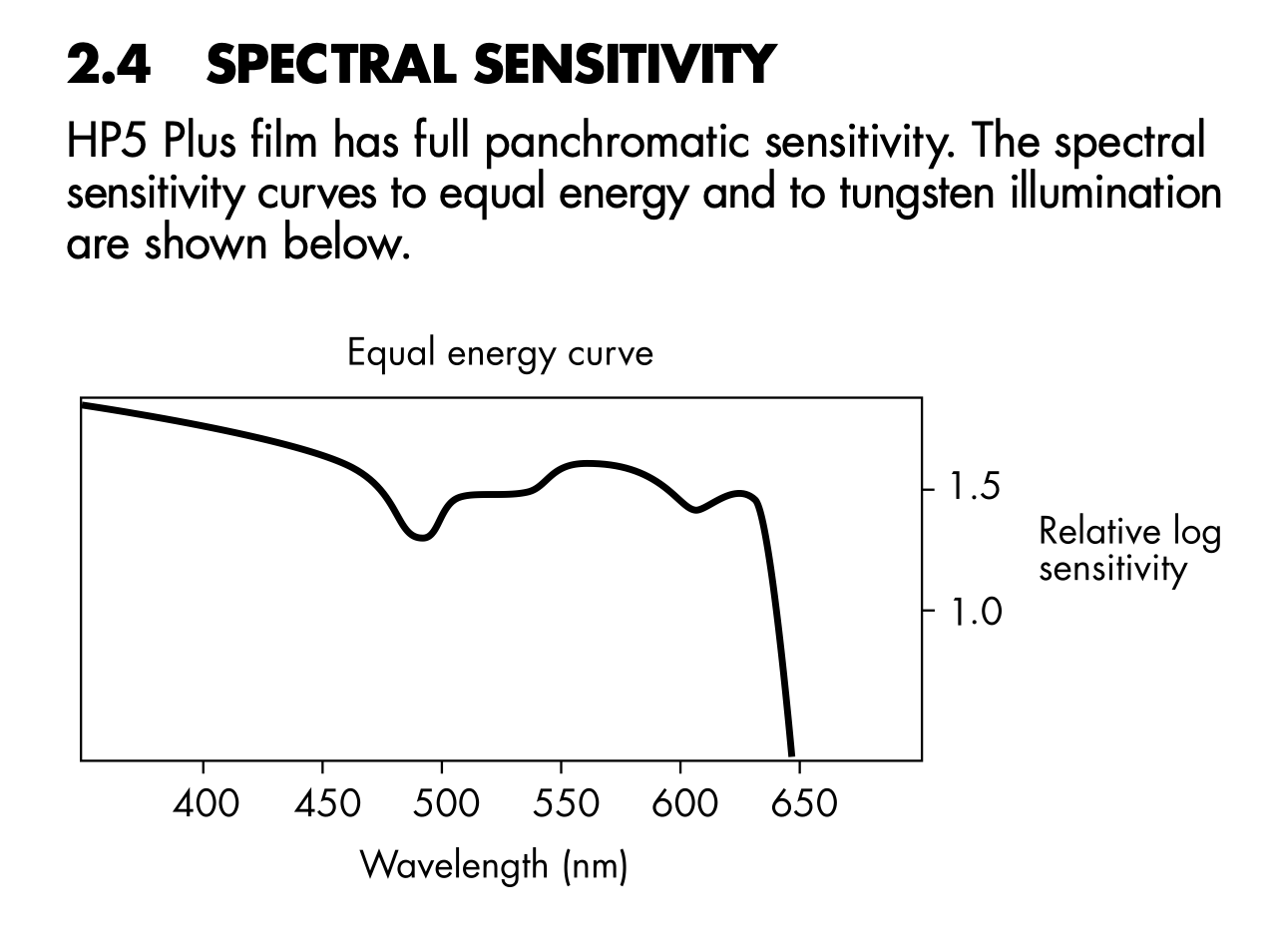

Ilford's data sheets used to be very comprehensive, but as I understand it, they reduced the amount of data published to reduce time consuming correspondence with those who couldn't or wouldn't read/ understand them. Agfa's Aviphot customers are military/ industrial & are expected to understand what they're seeing. Delta 3200 and Delta 400 seem to have re-started the somewhat more detailed info sheet. You can find the old HP5+ and FP4+ sheets etc on the web fairly easily. I've attached the equal energy plot of HP5+ from one of them.
Thanks Lachlan!
What do I search for though? “Old data sheets for XXX film” doesn’t seem to return any desired results.

This also requires an understanding of what a wedge spectrograms show you. The experimental method and the plotting convention are both very important.
There are relative and absolute plots, and more importantly unless the plot indicates equal energy in some way, the graph is telling you partly about the film and partly about the spectral power distribution of the light.
Perhaps most importantly, remember that in practice this all depends on your light meter’s spectral sensitivity, and of course the spectral power distribution of natural light varies throughout the day etc. etc. (and is never equal power either).
Most general purpose black and white films are roughly daylight-balanced. Technically, the manufacturer should indicate the spectral quality of the light used to determine the ISO speed and characteristic curves. In that sense, going back to Andrew’s earlier post, the characteristic curve is related to the spectral sensitivity curve.
From a practical perspective all you might need to know is that most black and white negative films are a little slower under tungsten light than daylight. However even that is usually a moot point since you are basing your exposures on meter readings.

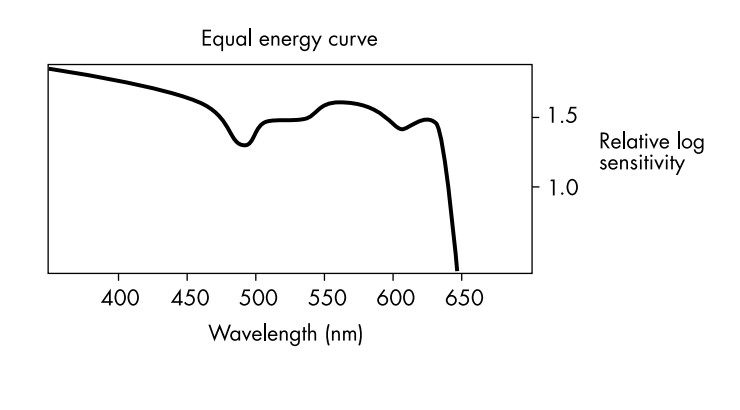

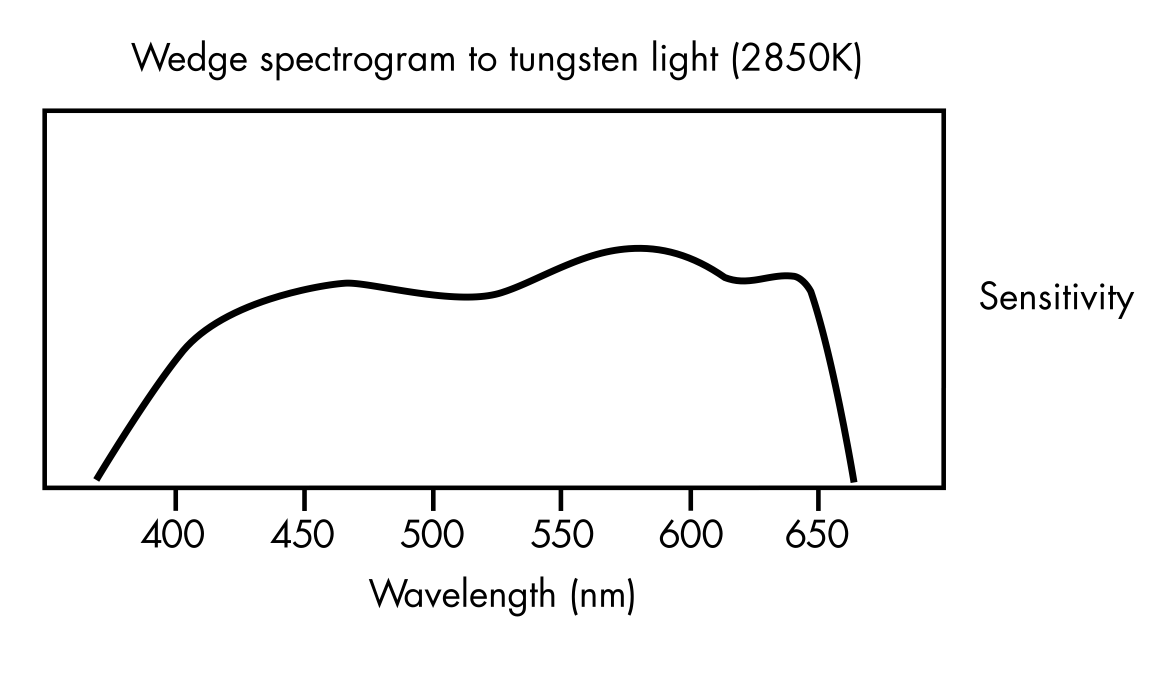

I just checked a random snapshot (4/1999) and the datasheets are there:
http://web.archive.org/web/19990418005459/http://www.ilford.com/html/us_english/bw.html
In fact, I just opened the one for Delta 100.
Ok, doesn't work on a phone for some reason.
For completenes sake:

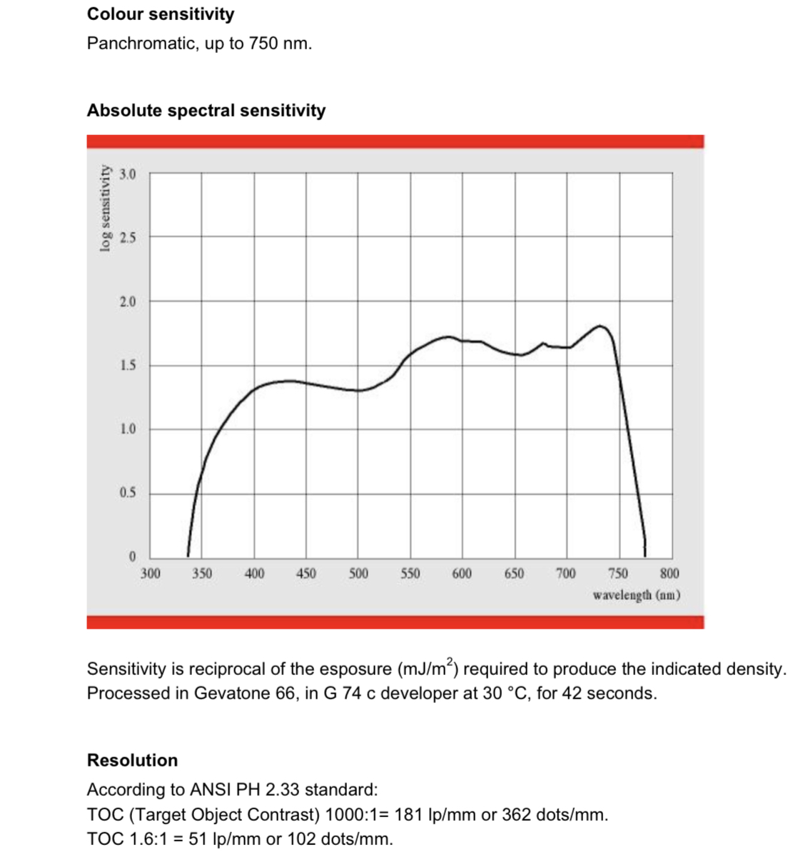

I'm finding it difficult to compare the two films in terms of spectral sensitivity because of the terminology and lack of detail. They both appear to be "absolute" sensitivity graphs however it is not clear to me what the light source is in the Aviphot case.
I'm pretty sure the Agfa Aviphot one is exposed to tungsten as well - the blue response is usually much higher on equal energy tests. I've attached the Agfa APX 200S data (extended red surveillance film) for comparison - Agfa tended to state that their spectral charts for still image/ ground level photographic materials were equal energy, though they don't repeat it in every data sheet.
So according to the curves and best interpretation of them, Aviphot 200 is quite a bit faster in tungsten like light (?).
If you're doing aerial photography you don't want the effective speed to vary by colour of light illuminating the subject(s) - and you want the speed loss of any filters to not be disproportionate at the redder end of the scale. Whereas at sea level for normal image-making outwith IR photography etc, people seem to find materials with slightly less extreme red coverage & slightly heightened green sensitivity more preferable overall.

Can you cast light onto whether SFX (also a surveillance film) based on HP5, is actually slower than Superpan/Aviphot 200, or faster/same speed?
From the above, I’d say that surprisingly, it’s slower.
From recall, SFX is a definite ISO 200, but it's intended for ground level use at what is regarded today as ISO contrast - Aviphot Pan is EAFS 200 at higher contrasts and altitudes - if it hits an EI of 125 in Scala (BW reversal can help speeds slightly) it's probably about the same or a bit less than 125 used as a neg at sea level. It may be that SFX has a stop of acutance dye in it or similar to cut off excess IR sensitivity - or internal reflections etc.
