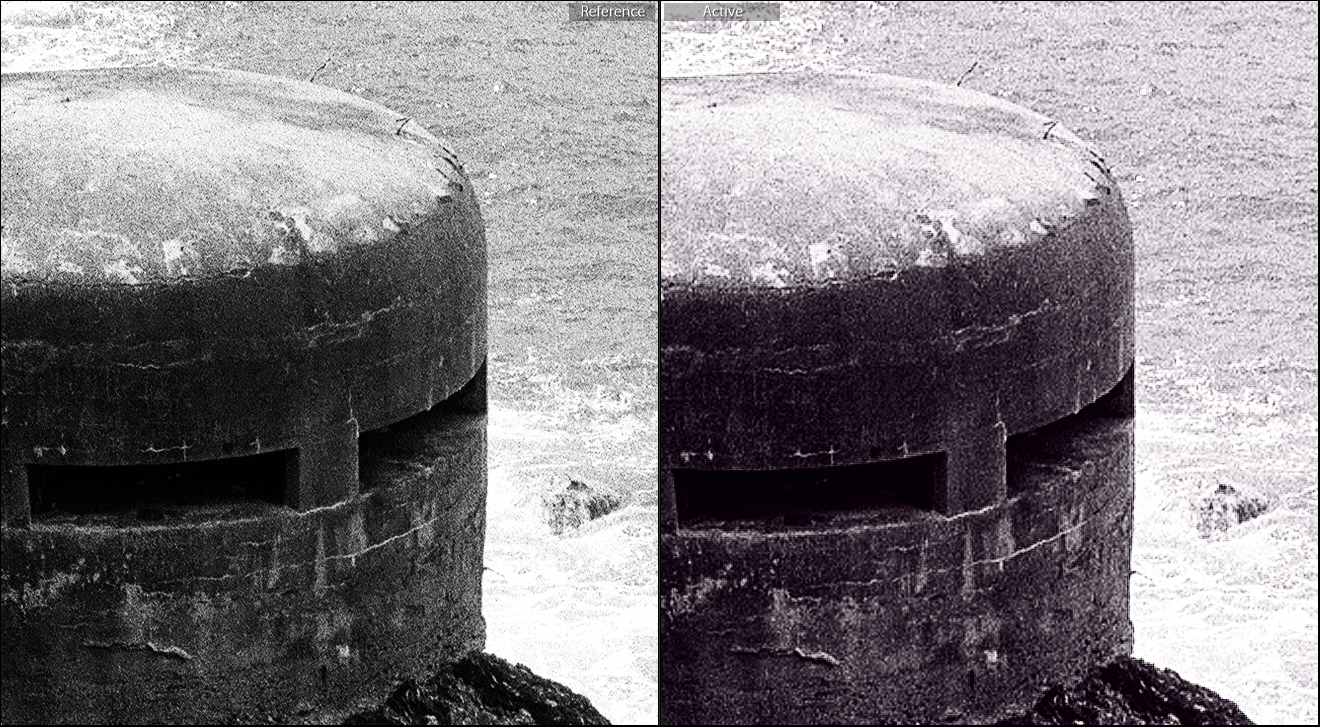

Hi all!
I'm fairly new to film photography, I have sent two rolls of Ilford HP5+ shot and developed at ISO 800 to a local lab for scanning. (Development was done in a different lab.) I am somewhat dissatisfied with the results, I find the pictures noisy and not in the pleasant grainy way that I am used to. I have uploaded some sample images (as a I have received them from the lab) here.
Do you guys think this is due to low quality scanning, or is this simply the way HP5 looks? Should I try to send the negatives to a different lab?
Thanks,
Peter

I admit being a total novice when it comes to HP5... but that looks like over-sharpening when viewed at 100%.
Here's a crop from the far right about 1/4 of the way from the top (level with the openings in the fortification):
Those jagged lines around the white spots are either sharpening artifacts, or high-compression JPG artifacts. Or both.

Peter, when I went back to film photography from digital, like you, I started with lab-scans and lab-processing. As somebody else said, the results from a Noritsu will be extremely hit-and-miss, and very much operator-dependent. In your samples, I see a combination of the following
-highlight clipping - probably due to automatic exposure
-blocked shadows
-oversharpening
-the first set of pictures seem to have a color dominant. Easily verifiable by importing in photoshop and checking whether they're in 'RGB' rather than 'grayscale' colourspace.
I only really started to enjoy my results again when I transitioned to self-scanning and self-developing. It's a long learning process (just as complex as wet lab printing, whatever the purists might say) but once you master the workflow you will get much better results than these.

I see - well, in any case, in my opinion the actual exposure decisions you took played a minor role in what we're seeing. I would say the results here are more due to the digitalisation choices made, perhaps automatically by the Noritsu.
Others have commented on the excessive sharpening. I agree, that's nasty. But there is more. I took the liberty of opening one of your scans in photoshop. The original is on the left. That's an RGB image, hence the colour (bluish in this case?) dominant. You might like or not like that - I personally don't. The grayscale version is top right. The histogram of the grayscale version is bottom right. What you can see immediately is that the highlights are clipped. Of course, we would need to check the negative, first, to understand if they are clipped as a result of your exposure choices or of the chemical processing.
We don't have your negatives, so let's assume that the information is in the negative. I strongly suspect it is.
Then, it is likely that in an effort to preserve detail in the rocks, the scanner software probably did an automatic assessment and decided the highlights were worth losing to save the general tone of the image - an Ansel Adams fan would say that the scanner software 'tried to place the rocks in the foreground in zone V'. If you YOU had done that scan, you would have decided which gray tone to place those rock, and would have perhaps made them darker, in order to save the highlights, that frothy seawater which is now a white indistinct mess.
