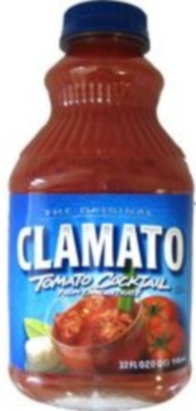

Would I need to buy a special container for d76?
One or more empty, cleaned out and clearly re-labelled plastic beverage (soda pop or tomato juice) bottles make great containers for darkroom chemistry.
I use these (inherently Canadian as they are):
