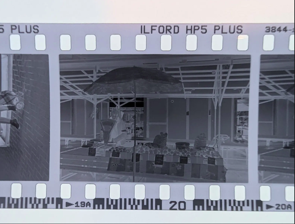

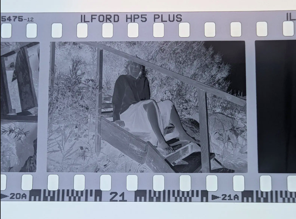

Looking at the negatives (and the new scans) they don't look to me underexposed. I see plenty of details in the shadows. Although the image of the market stall seems to be very flat.
So I probably created for myself a problem that doesn't really exist by scanning the negatives badly and jumping to a conclusion, looking at these scans, that there is bigger than usual grain.
What do you think now looking at the digital photos of the negatives themselves and the new scans? Do you think there is still too much grain or they look ok to you? Do you still think they are underexposed?

Here is the backlit digital photos of the negatives themselves:
Example 1 - negative
Example 2 - negative

Backlit images of the negatives embedded for you. :smile:
The exposure looks better than we thought initially, although the second example could probably benefit with a bit more..
They look fine. And surprisingly, the market stall image looks anything but underexposed. In fact, it's quite dense. And what confused me a little is better visible in this new scan - there's just some flare due to the lighting and the lens catching some of the direct light hitting it over the top of the stall/umbrella. This reduces contrast - and boosting that back up in digital editing will emphasize grain. So yes, that negative is quite flat, but it's not a problem with the film or processing. If you want to avoid this, use a lens shade, a more modern lens that's less prone to flare, and/or point the lens away from light sources.
Everything looks pretty normal to me; I think you're doing just fine!
The first shot is lovely - very natural, beautiful light. Exposure, development and scan right on the nail, to my eyes. The apparent graininess is now more or less what I'd expect for a scan from HP5+ in 35mm, but will certainly be less in a darkroom print.
A problem for the second shot is that under that canopy the light is highly diffused, and as a result the focal area is low in contrast anyway, even without the effect of the flare. Actually rather difficult conditions.
