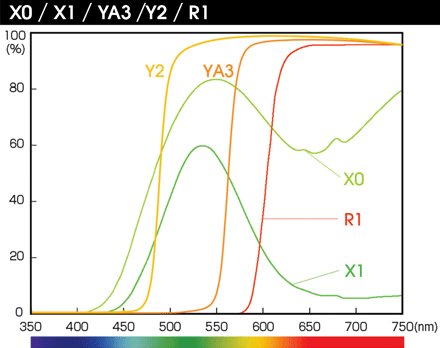

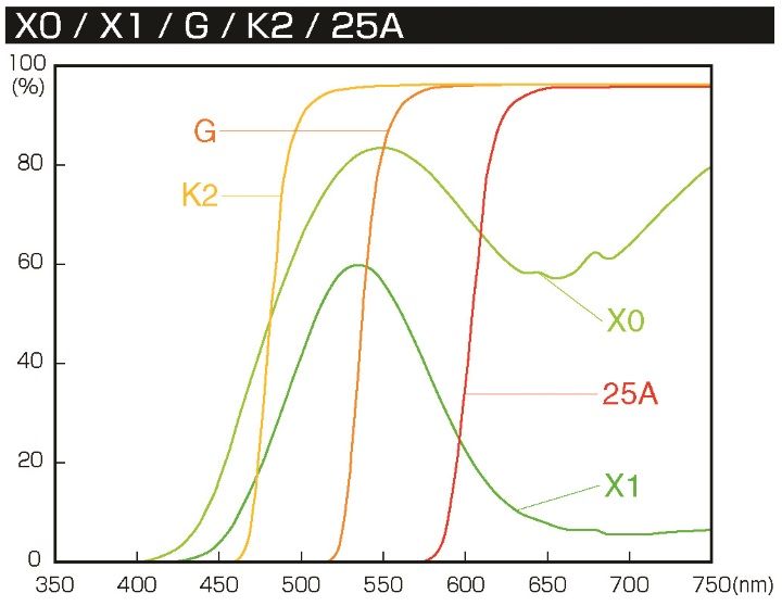

Looking at transmission curves, K2 transmits ever so slightly more light on the short wavelength end than the Y2 (based on intersect with the X0 and X1 curves, assuming those are the same; Y2 seems has a higher cutoff wavelength, but only barely). Practically, though, you might say their cutoffs are the same. The Y2 also seems to have slightly higher transmission around the peak at 600nm, where transmission seems to be around 98%, while the K2 seems to be flat at about 95% transmission from ~500nm upwards
So, as Ian has just said whilst I was writing this, differences would be very subtle.

Thanks for digging up the K2 curve @Ian C and posting them side by side @Daniel Stuefer !
Here's an overlay of both:
It confirms what @Daniel Stuefer says above.
The K2 filter is a little 'less yellow' than the Y2 filter, so the Y2 will have a slightly stronger filter effect as it attenuates a bit more of the blue spectrum.
I doubt the difference is apparent in normal photography.
