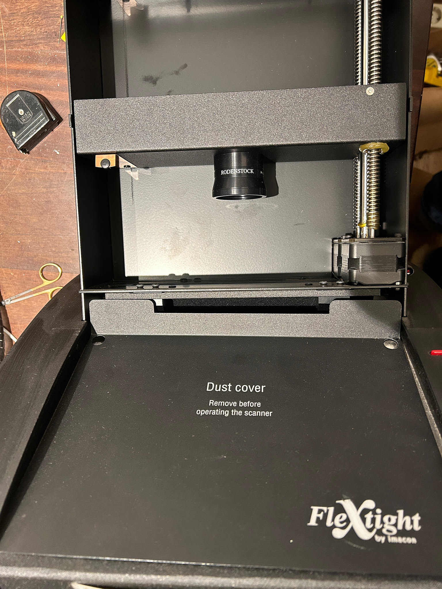

The Flextight will be far, far easier to use. The whole business of mounting negatives on a mounting station, and having to deal with legacy hardware (SCSI) will be a pain in the posterior. I'd only go there if you really, really need to for some reason. The Flextight will already be annoying enough given its slow scan speed and the need to interface with FireWire, but at least it's still sort of manageable.

I have a Imacon Flextight and used it a lot. But a modern DSLR like a Nikon D850 with some negative holder to keep the negative flat and a supreme optic like a Apo-Gerogon can outperform the Imacon.

one the problem with the Imacon/Hasselblad scanners is that their total resolution (8000pixels wide) is fixed independent of the film format. that means for 4x5" we're getting 2040ppi nominal resolution, which is fine for small and medium prints, but totally inadequate for big enlargements. (ie everything over 20"/55cm)
other problems include distortions of the image, uneven focus and color fringing at edges.
here are two crops of a medium format TMX on an Imacon at 3200ppi (scanned three times to show the distortions and focus issues) vs 11'000ppi on my scanner:
