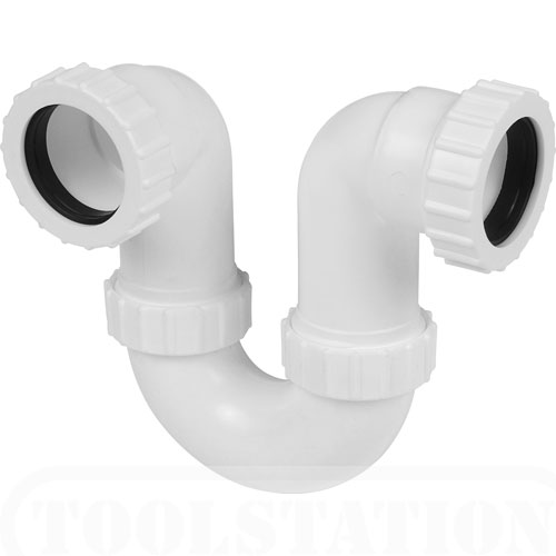

I would add a running trap to the system just to make sure. I don't know if you use the same name for it in the US but in the UK a running trap is one that fits in line with the pipe rather than as part of a waste in a sink or basin.
I would trust water blocking the pipe more than a check valve to stop foul gas.
Steve
