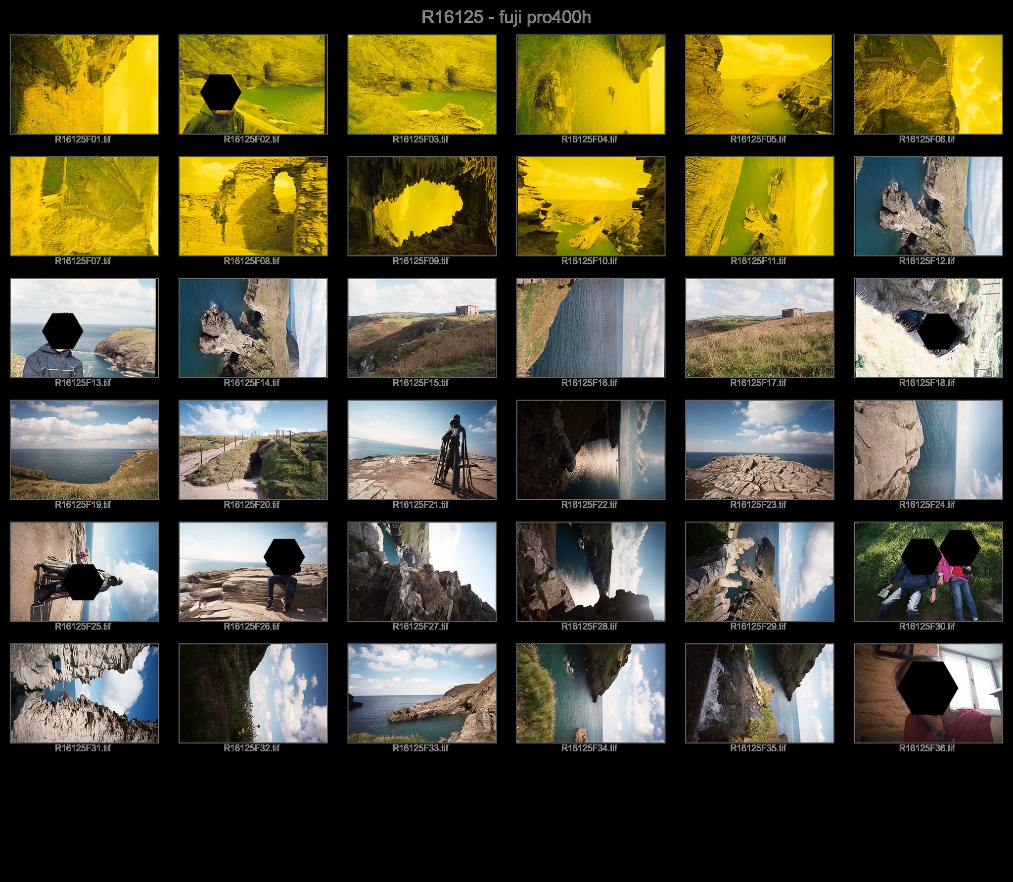

Only took me 1/3rd of a roll to realise, not a full roll. it didn't even occur to me to try and remove the yellow cast, I just embraced the black and white conversion. Definitely a learning exercise, I haven't done this since (8 years ago now.)
