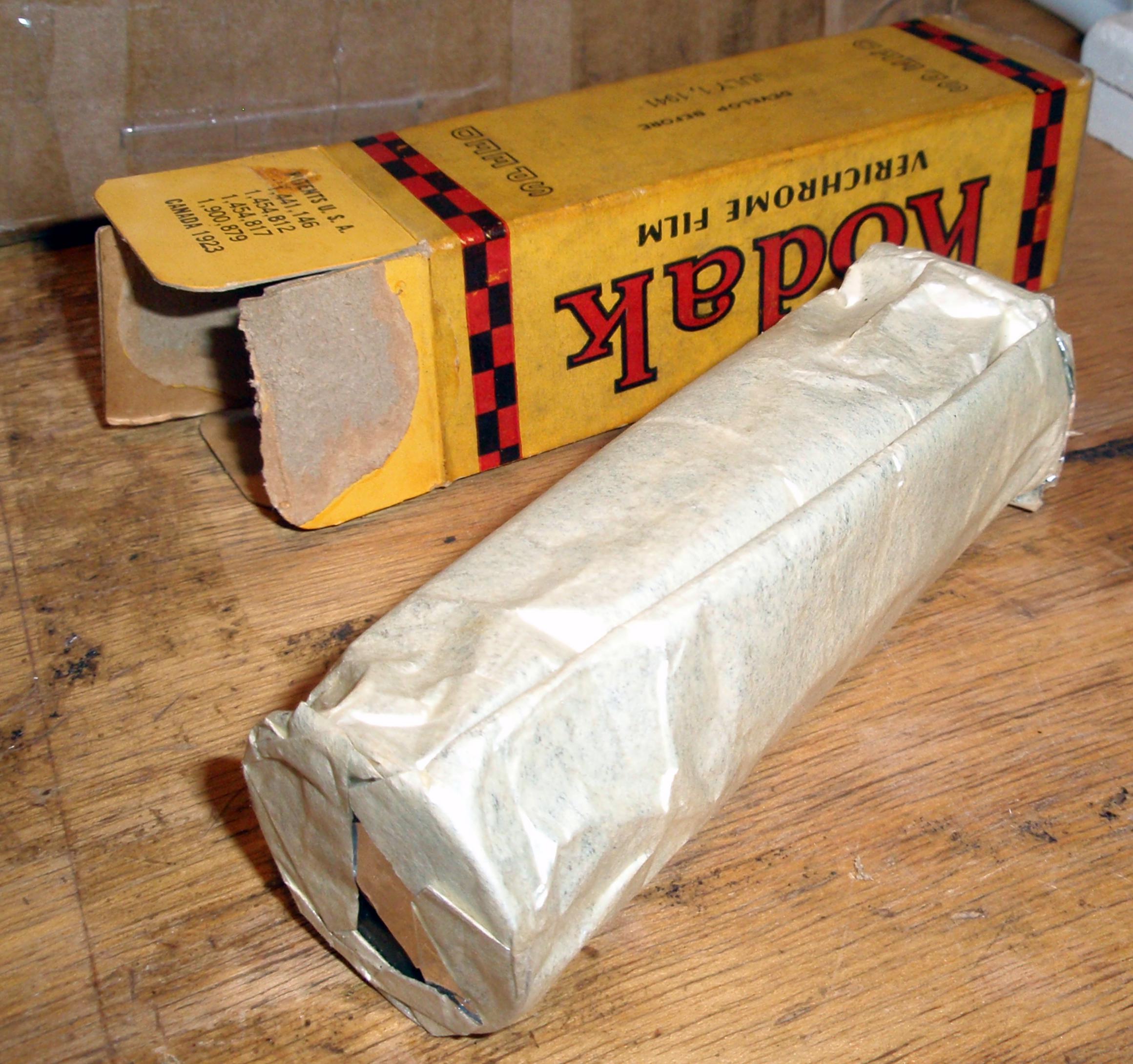

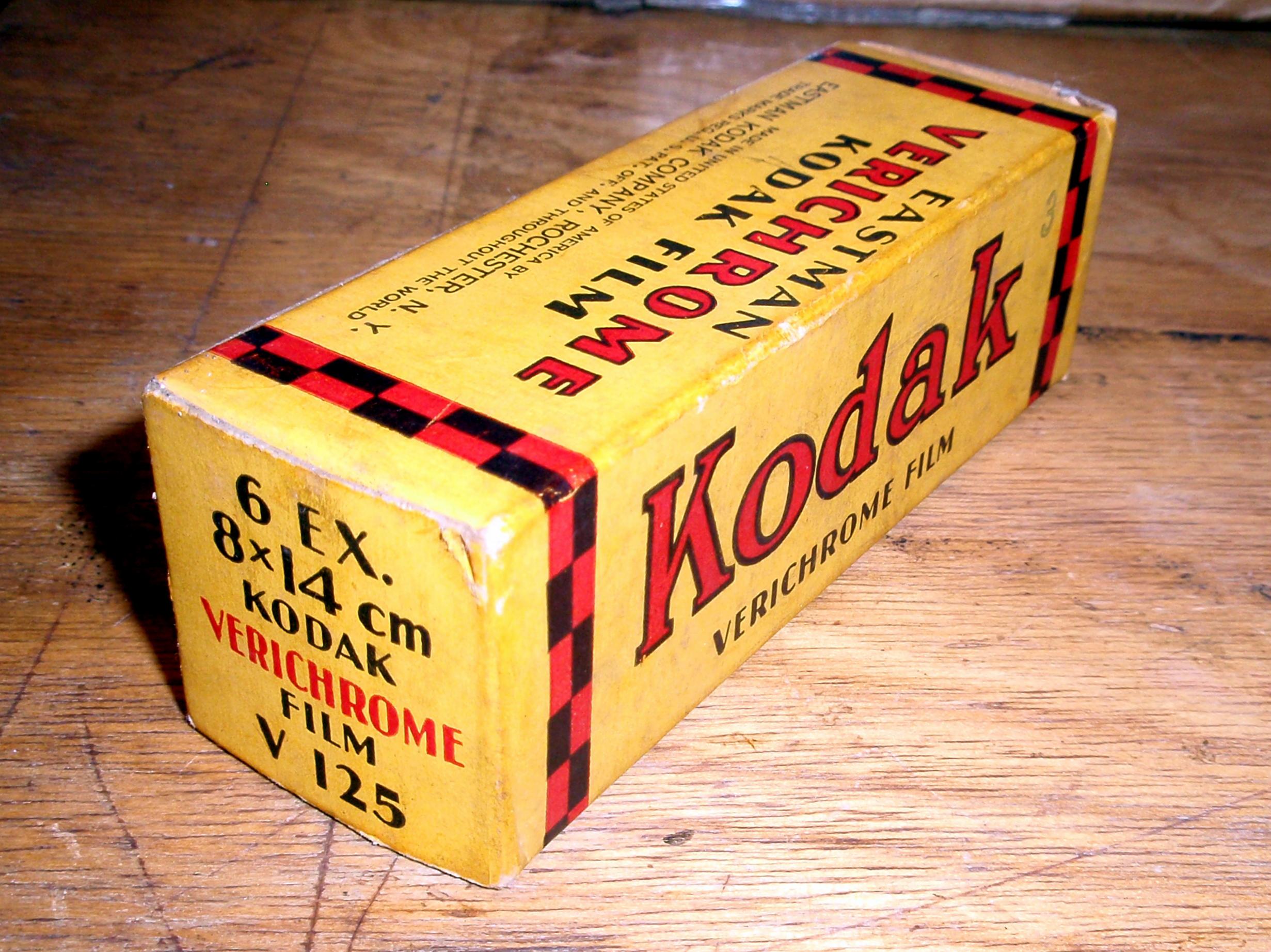

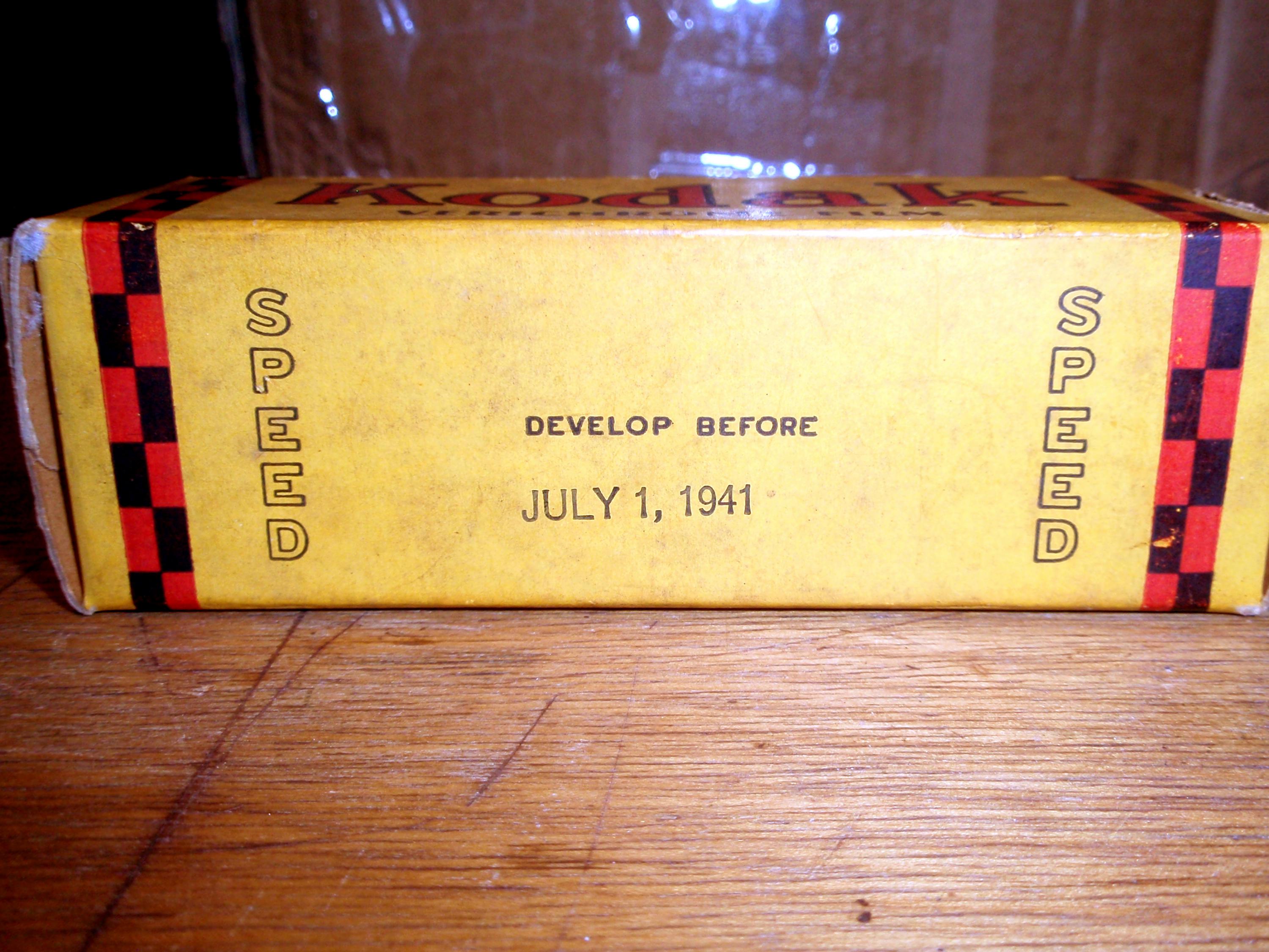

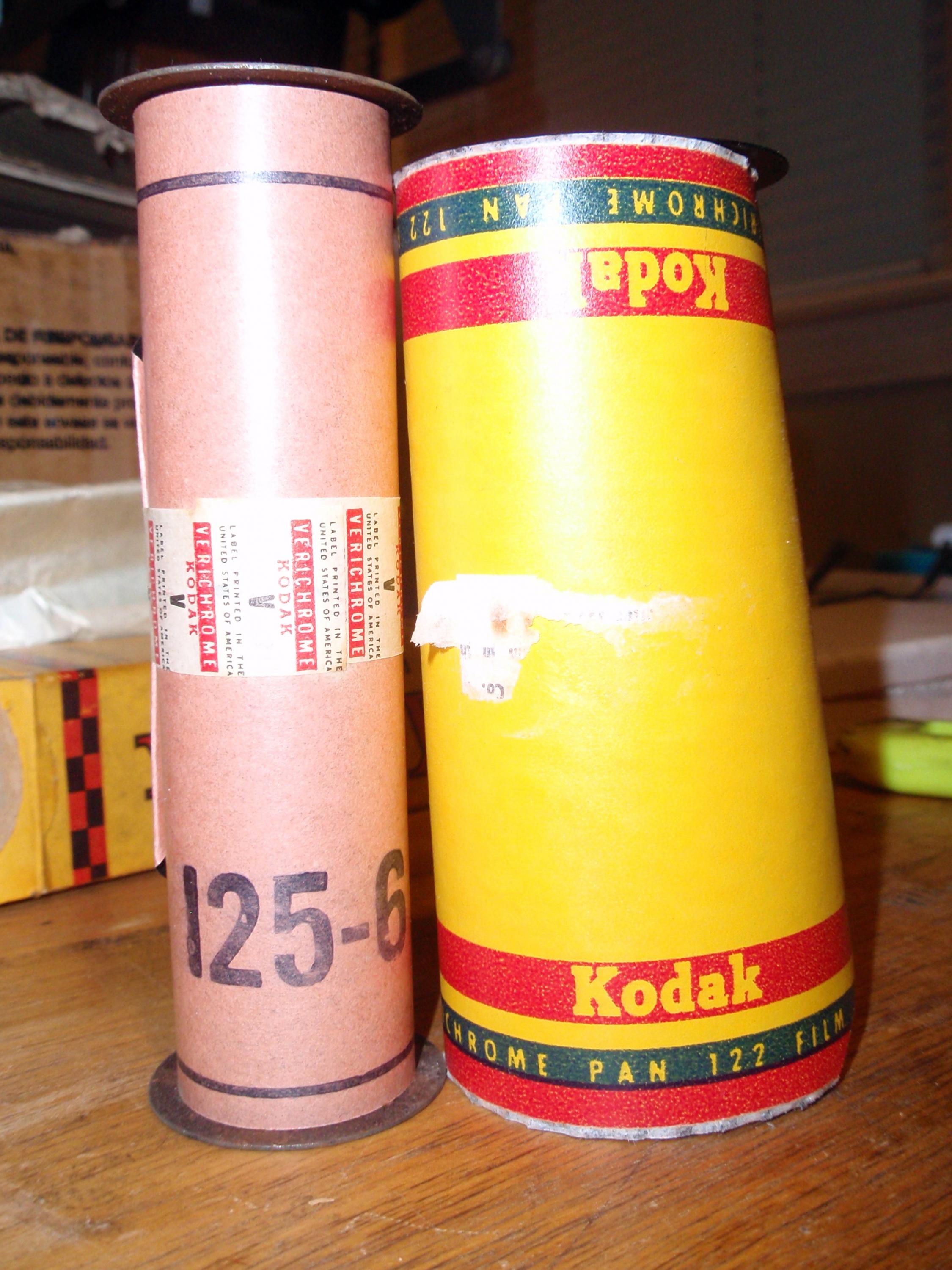

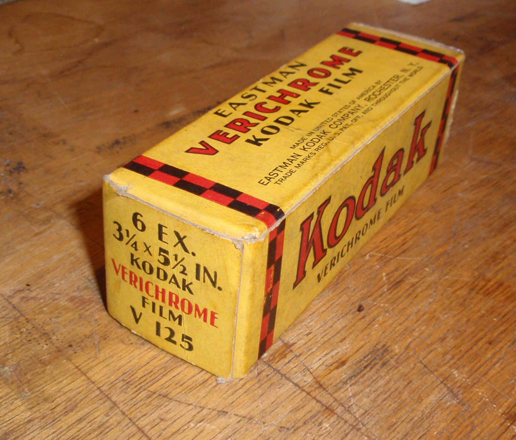

I measured the 125 spool and it is 3 15/16" (or about 100mm) long. It is about 3/16" longer than the 122 spool. I can't find my vernier caliper, so I can't give you a more accurate measurement.
I took photos of the spool and package. I'll post those a little later.
ctsundevil
Mar 31, 2008
57
Connecticut
Med. Format RF
Here are a few photos of the 125 film. P2230345.jpg P2230346.jpg P2230347.jpg P2230348.jpg P2230349.jpg

OK, so I found an older roll of 125 film on that auction site. I was the only bidder, so got it at $19.95. Band says develop before Sept. 1, 1912. Now I've used outdated film before, but this is ridiculous...
So, the spool. I posted above that I'd gotten a 103 spool, and it does in fact fit this camera. Now I received the 125-6 and guess what: Not only the spool the same size as 103 (meaning the table is wrong), it's apparently spooled on an actual 103 spool, which I measured right at 3.912". You can tell because the older spools were drilled right through, with the leader slot off-center so as not to go through the center hole, thereby to allow the removable winding key that the old Bullet #3's used to fit in there, and the end opposite the keyslot has three holes in a triangle for the old-style brass driver that the winding key screwed into.
Note that this is probably Kodak NC film; the Verichrome in the post above this one may have a totally different spool. I wonder if this was an early production run and they were trying to use up backstock of older spools.

The verichrome spool could very well be the same as a 103 spool. I don't have one to compare it with. When I measured that one, I couldn't find my caliper and used an old machinist ruler to measure it. 3 15/16" is 3.9375", the .0255" difference is less than 1/32" - well within the margin of error on my ruler.
I would have to guess that your older spool and this one are exactly the same.
