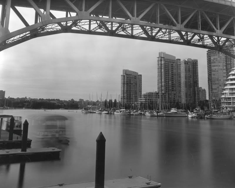

Hey guys. So I finally did my prints today of the 4x5 shots. For some reason they look much better on full size prints than they do on the contact sheets. There is still what looks blotchy in the sky, although it's not terrible. The scan is pretty bad, just quick and full of dust, but here's is a shot of Vancouver from Granville Island:
What do you guys think?
