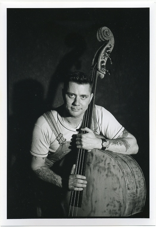

My Friend Andy. A true Rockabilly stand up Bass player. Leica M6 with 50mm Summicron and Tri-X in HC-110 B.
He is a shy person, despite his on stage persona and I was having a hard time getting him to relax. In the end I told him to hold it like a woman and this resulted. Lit with a single flash head and honeycomb in a very cramped space, hence the 50mm instead of the 90 I would like to have used. (I was after a Herman Leonard sort of look).

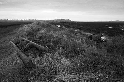

The picture on the index of my website is an important one to me at the moment. I include a thumbnail but there's a better view here For me it is full of personal resonance, but it also has a kind of classical look. The irony is, that this was very literally a 'grab' shot. It's one of a growing number of 'accidentals' that I seem to be gathering along the way – when my purpose is focussed on something else – usually the landscape or smaller outside 'scapes' - and then turned to my youngest son.
I was taking pictures of landscape, and then looked to the right to see my son in this position. I have to say my heart did leap a bit, because the whole landscape (as well as seeing him within it), looked so beautiful, in the winter early morning. (The technical bit - I couldn't take a picture with the Mamiya without taking a giant leap 10 or 20 yard backwards, so I put down the camera, and picked up the FM3a at my feet, using aperture-priority, manual 28mm nikkor lens & the film was Tri X) and got the picture before he moved – although aware of me - and there it is, a 'snap'.
The landscape is one I've known since my earliest teens. So is it a 'snap'? A self-portrait? Or a portrait? Or a landscape? Both? All? On my site I put it in the landscape section, but that was more a question of context than anything else. There's a lot of me in it, it could be seen it as a journey to my past and also my future there, with him. But that seems contrived, and seen in retrospect.
There's more in it of him – he had no direction from me but just at that moment his presence, his posture, the waves of grass, the landscape, my position with a camera and lens that could take it all in, all came together and I was lucky enough to be there. Whether I managed to capture and communicate what I sensed and felt there is another story. I like that he is looking straight at the camera. And he has known the land since he was born, he has his own claim on it. I love the way he always lies and rolls in it. That won't last for long.

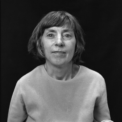

Like other photographers here, I find it hard to get people to relax and give me natural expressions. Recently I shot a group of seniors and disabled people at a local church. I found the disabled people easiest to shoot. When I asked them to smile, they smiled! Beautifully, and without reservation.
This woman is almost totally disabled. She is in a wheelchair and can't speak, but she is still very expressive:
