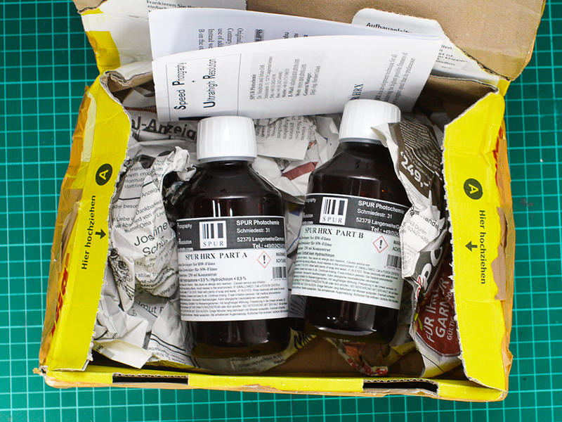

its arrived.. I'll do some test as soon as I have time
