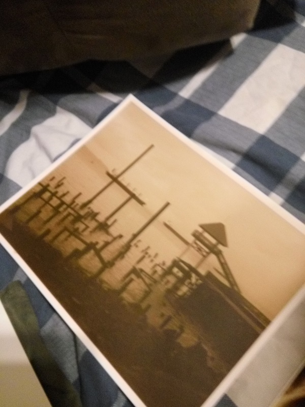

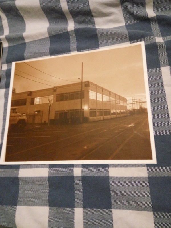

I dove in headfirst today. Pretty pleased with the results, but it is definitely something to reserve a whole day for with many prints.
Tried indirect at 1:75 for 6 minutes, then my personal favourite 30+ minutes bleached to midtones. This really lightened the shadows and uplifted the prints. I can see how an initial selenium toning to beat the blacks down first would help in other scenarios but it turned out perfectly. The sulfide seems to overpower the selenium. The colour before dry down is a lovely orange. I will definitely be ordering this one again.

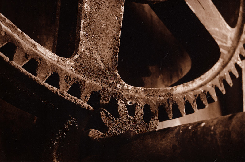

This is MT2 carbon toner 1+40 on Ilford MGWT after selenium and bleaching.
Drive (FB version)
by Lars Von Wedel, on Flickr
From the following snapshot (all MT2 carbon toner), the first two are MGWT, the third is Adox MCC. All selenium toned, bleached to the shadows, then toned 1+40.
20170802-img_5663-jpg.183692
