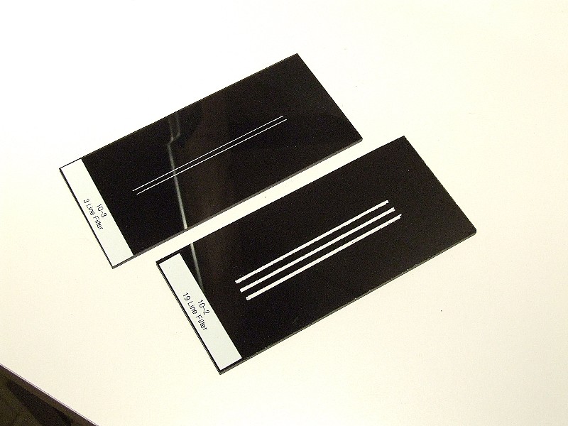

Without a formal sensitometer I would suggest rigging up a system. If I were gonna do it I'd probably base it on an electronic flash in a darkroom, maybe a hot-shoe style flash, firing at full power to keep the exposure as long as possible. If you fire it from a distance, to minimize side-to-side fall-off, and use some sort of diffuser over the front to make sure that no optical pattern is projected, I think this ought to work pretty well. Now, I have not actually done this, so there may be something I'm overlooking (does it have enough power, etc.).
This is the basis for the EG&G PH-10 Mark VI Sensitometer. Basically a strobe tube in a box pointing up, with a platen that holds the step wedge behind a glass plate. The hinged cover has foam on the underside to insure flatness of the film being tested and when you lower the cover and press lightly down on the handle, it closes a momentary contact switch and exposes the wedge onto the film. The EG&G unit has a push-button selector for intensity, probably a capacitor network of varying power, but this can be simulated by building a slot in the box and making an ND frame to slide over the flash head or by varying the output power of the strobe itself.
