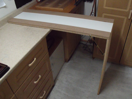

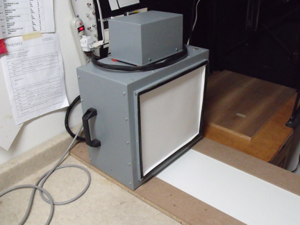

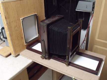

Hi Charlie - I have exactly what you are wanting to do. It's much easier than people might think and works great. The main thing is to have a light source that will work for you. I was lucky and found a 10 x 10 cold light head from an old Durst enlarger on Ebay and it works great. Recommend you talk with Sunbeamland about his cold light head that he is offering. The camera I use is an old Kodak 8 x 10 2D and you don't need to make any modifications to it at all. Get an old wooden 8 x 10 film holder and cut out the internal septum just smaller than your film and it becomes your negative holder. With my cold light head, I didn't need the ground glass back so I just removed it from the camera. You'll need to make a base that the camera slides on. Mine is just a plywood sheet that hangs off the edge of the counter with a front piece that sits on the floor. I made a panel out of plywood that goes between the cold light head and the back of the camera to help with the seal between the two but I still get some light leaks. So, I just throw a big piece of red fabric over the top of everything and it takes care of that. The one thing that is important is that you need to be aware of the distance between the front of the camera and the wall where you will mount your enlarging paper. It can't be too far such that you when you look through your focusing scope you can still still reach the camera adjust the focus. I have two lenses I use - a 360 Rodenstock and a 240 Nikon (for big enlargements). These big lenses are not all that expensive when you can find them off of old process cameras. Feel free to PM me and I can send you more photos and answer questions.
