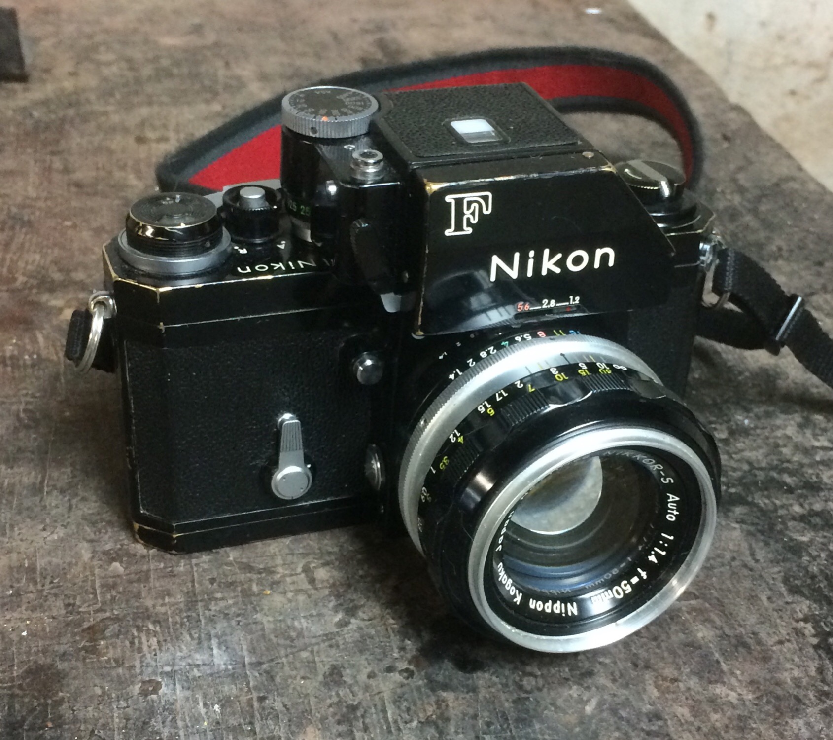

Why not just buy one really good SLR with a good reputation and hope for the best? Hard to go wrong with any Nikon F.

View attachment 241632 Why not just buy one really good SLR with a good reputation and hope for the best? Hard to go wrong with any Nikon F.
For sure the F was on my mind. But because I'm in a large enough city, too many people know about the F and the prices are too high. [At least too high for someone not confident that I'm "good enough" to shoot film and thus, at the moment, just dabbling.]
There are no great thrift store or pawn shop finds in my city (that I've seen).
