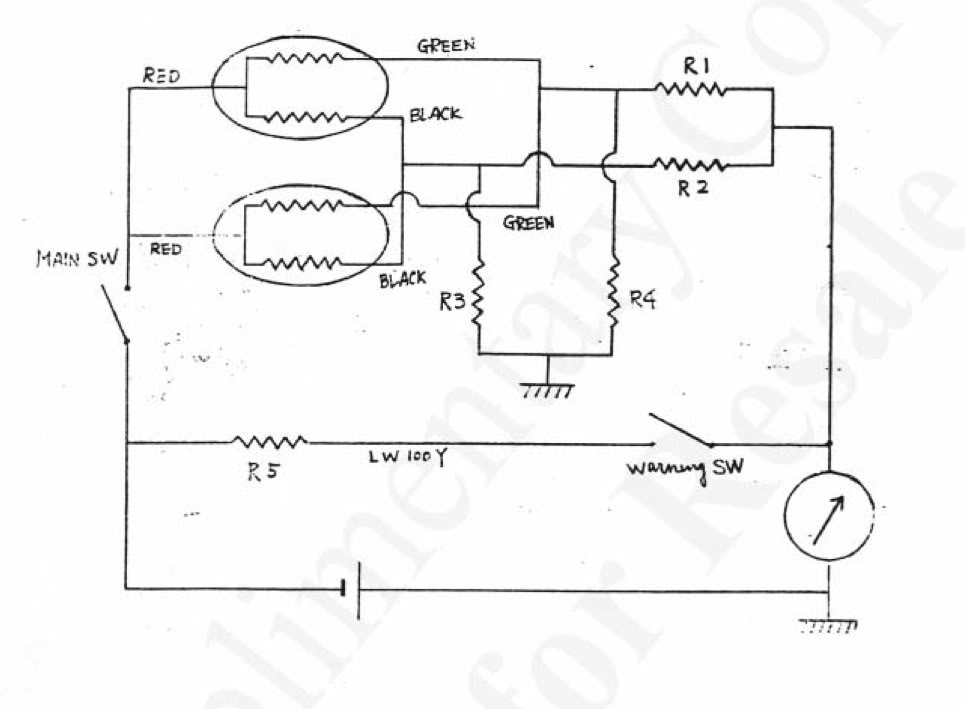

Thank you for your advice. I may have discovered a problem? The movement of the needle appears sensitive and unpredictable to gentle pressure to the casing of the galvanometer or to the nearby camera casing. A short?
