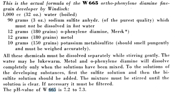

The Manual of Modern Photography is on Internet Archive - here. It contains the formula for W665:
I'm not sure if there's a replenishment formula, but I don't think simply pouring more in will work to combat the bromide buildup, nor will adding kodalk or some other alkaline - which I think would change the nature of the developer. I'm sure someone here would be able to point you in the right direction. But I think I'd just use it as specified.

The W665 formula was closely related to D25. So adding metaborate like DK25R would do the trick I guess.
DK-25R
Water 50C 700ml
Metol 10g
Sodium sulphite 100g
Sodium metaborate 20g
Water to make 1 Ltr
W665-R (Possible)
Water 50C 700ml
Metol *16g
OPD *16g
Sodium sulphite *90g
Water to make 1 Ltr
Undoubtedly, it would work - as in, it would keep the developer active. It might be a bit tricky to use it as a replenisher and keep the developer's characteristics consistent. DK25 has only metol as a developing agent. Is there is any superadditivity to metol+opd? But it would be a starting point for experimentation.
