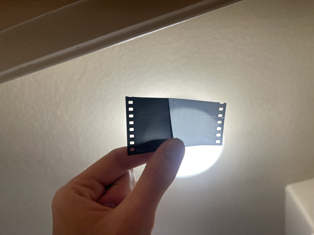

Well, the 70mm 2424 that I have appears to have some pretty major base fog, which wasn’t entirely unexpected, but nonetheless is disappointing considering that we were told that it was freezer stored for its entire life. Thankfully, me and my friend did not break the bank buying this film, however, now I am faced with the prospect of trying to figure out how to use it.
I did try and develop it in HC 110 B with 0.4 g/L of potassium bromide, but that did not seem to make any significant difference.
Has anyone ever shot HIE with this amount of fog? And is there a way to reduce it? I understand that anything I try will probably reduce the usable speed drastically, but the key word there is usable, as with this much fog I very much doubt I will get very many usable images as-is.
And as a note, while I would like to try and conserve it as much as possible, I do still have something like 70 feet of the stuff, so I do have a little bit to play with.
Thanks in advance.

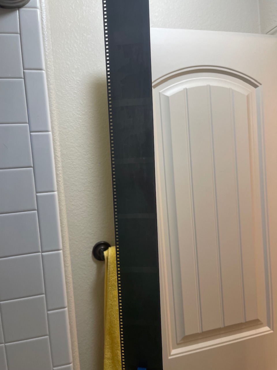

Well, I know that this is an absolutely horrible picture of the film, and it’s really hard to see anything, but there is definitely an image there. Also took a pic with my phone and the IR filter for reference. Unfortunately, I won’t be able to scan these for a while, I bought a 50s 5/2.8 lens and sold my old 55/3.5, which means at the moment I do not have a macro lens. So no scanning.

Looking at the film, it seems like it didn’t really loose speed, just got fogged. Some of the shots with low EI are definitely overexposed. The highlights are blown out.

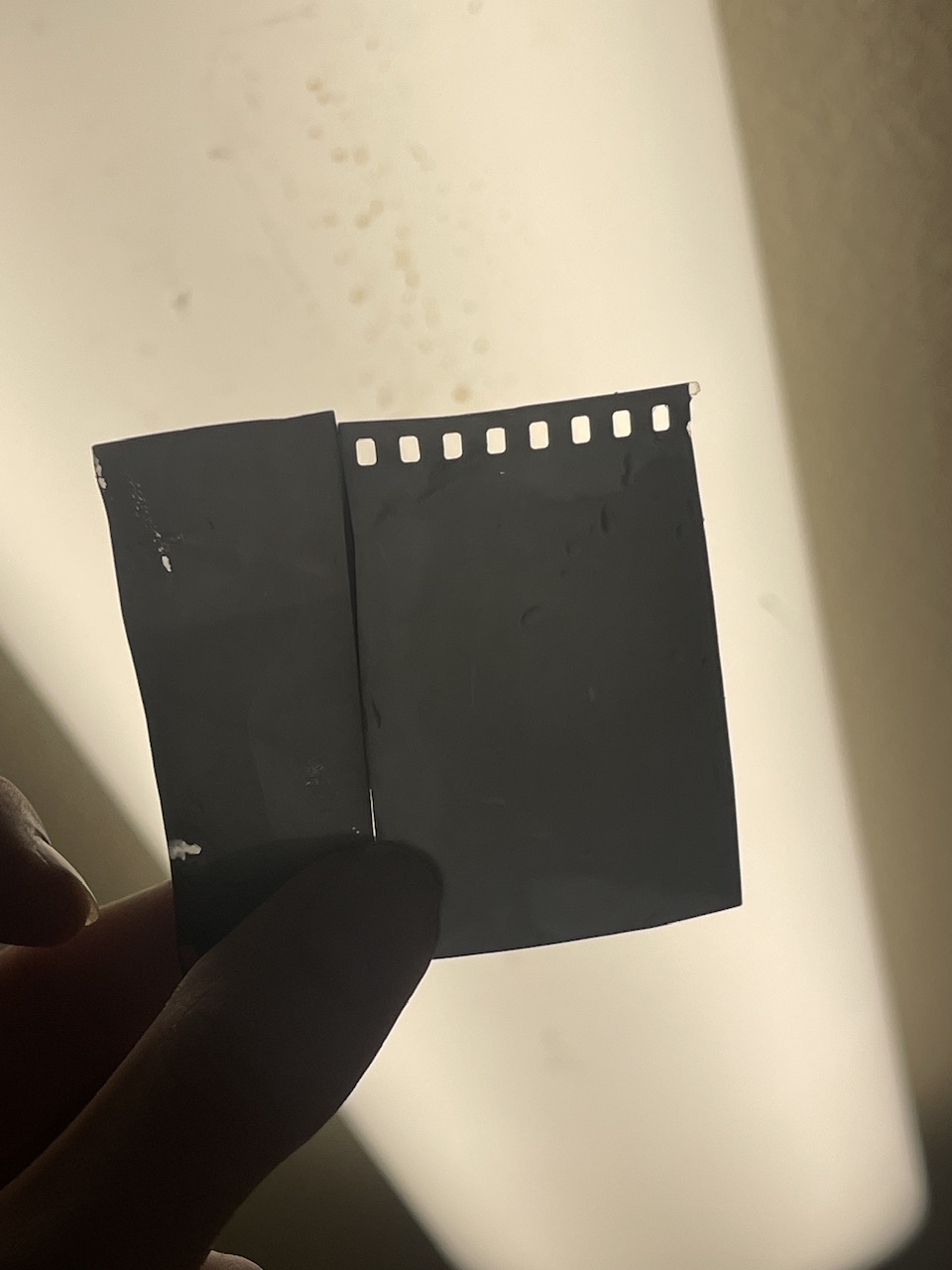

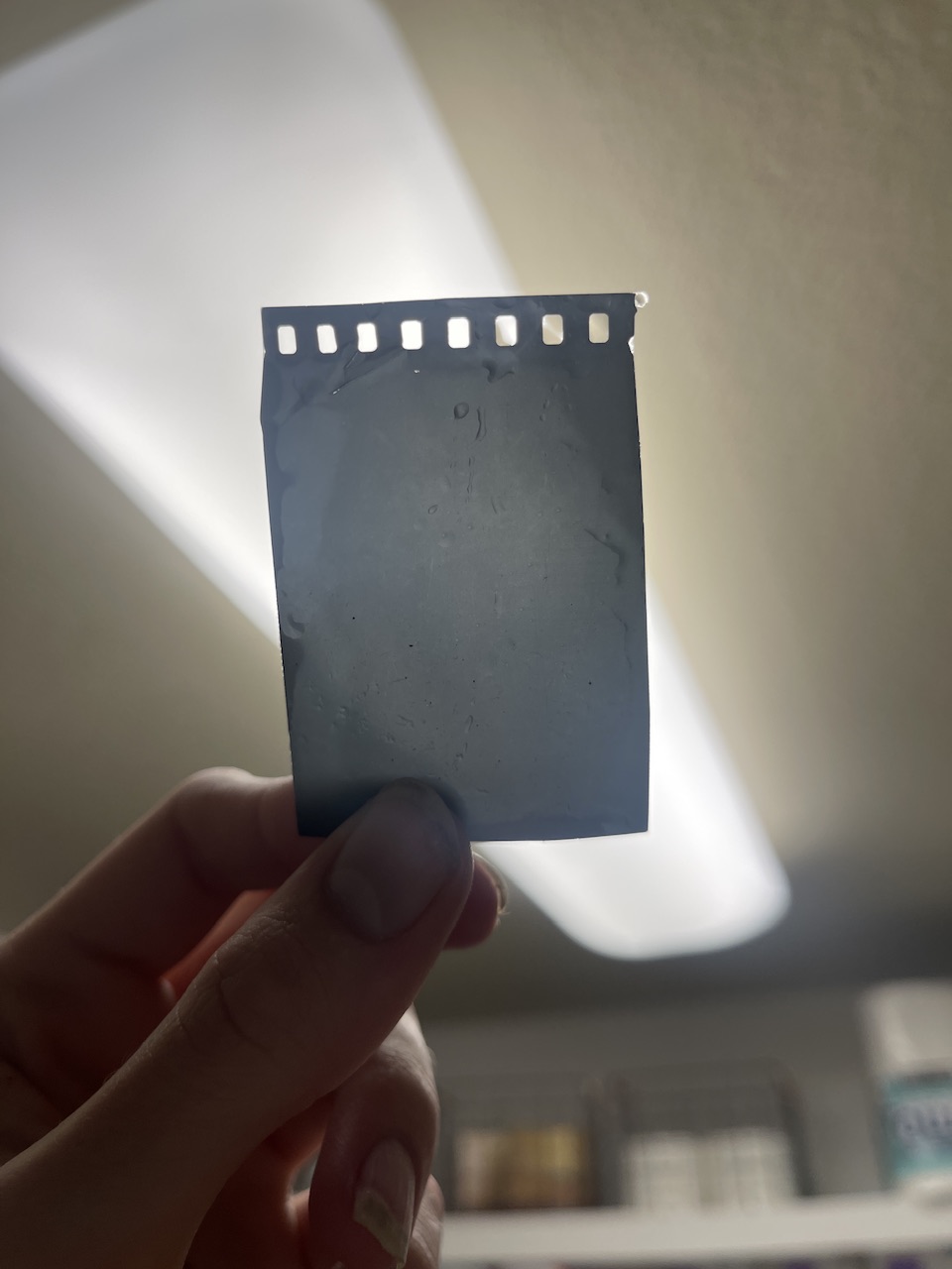

I was given the cursed idea of using C41 blix as a reducer for the HIE, now I really wanna try it. I do have an old C41 kit still kicking around here somewhere, and I also have a couple inches of blank film on the end of the roll that I developed, so I could definitely find a clear time. Might give it a shot.
